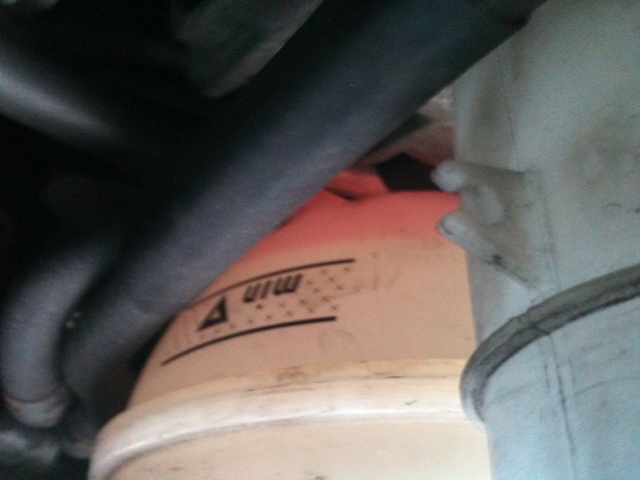

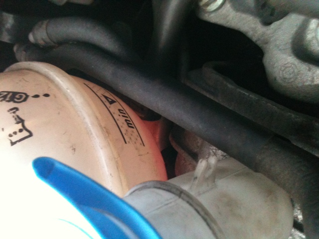

+1 on various leak locations, but it is worth (or laziest ;) ) to check first right under the coolant bottle.
If you see coolant leaking from under the bottle, clean the coolant cap seal and the bottle opening first, replace the cap.
Be careful when opening the cap on a hot engine.
If it is still leaking from the bottle after cleaning the cap, either the coolant cap is opening under lower pressure than it should (?1.5bar, but do not quote me on that) and needs to be replaced, or your engine's head gasket is leaking exhaust into the coolant. At early stages, it looks exactly as you described, and coolant still looks clean. Had it on the 1,9 after dealership did not refill engine's head properly with coolant (TB/WP job) . Only later you notice exhaust dirt in the coolant, but by then the engine used more coolant then water :(
