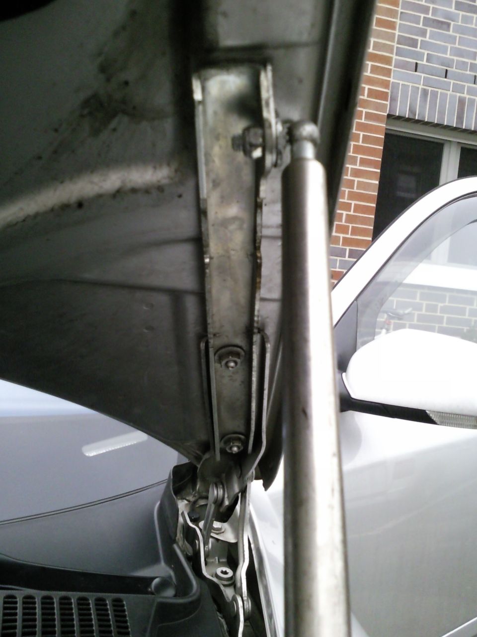

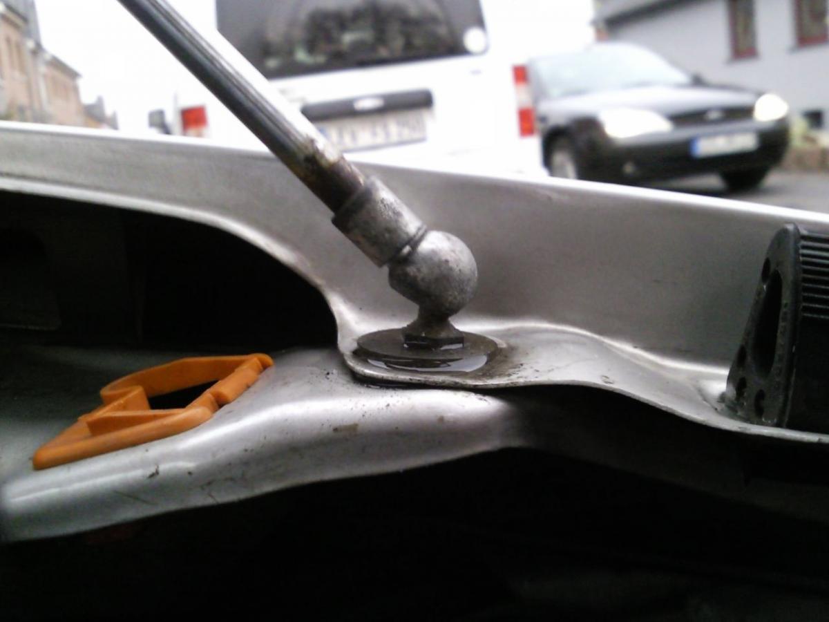

Some pictures I found of my Milotec damper.
the Milotec one seems interesting but also a bit of a pain to do if you need to undo the bonnet.
Better do that with a second person. I did it alone and it worked. Bit tricky, but if you do it slowly it will work without dealigning the bonnet.
