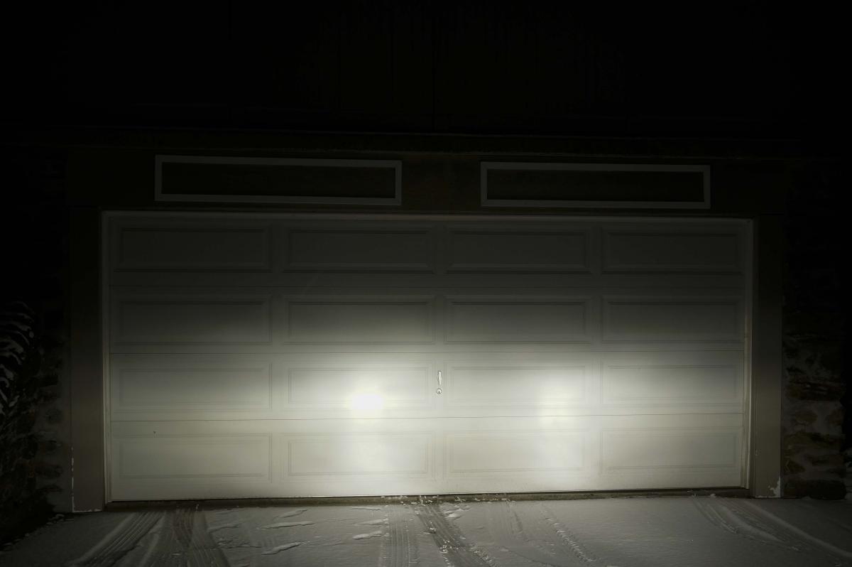

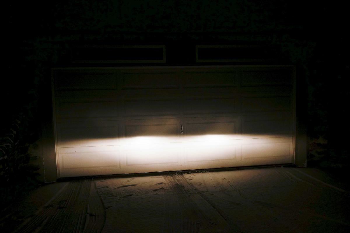

I've attached an example of halogen vs VLED LMZ in a dipped reflector and it's not good at all.
Even the VLED's LMZ aren't suitable for a dipped/low beam reflector. On their webpage http://www.vleds.com/h7-lmz-3578.html they state 'RECOMMENDED FOR PROJECTORS & OPEN REFLECTOR HIGH BEAMS' which is because they simply don't match a halogen bulb for light placement. You won't get the focus and hotspot you will from a halogen which means less usable output and added glare.
I'm all for brighter lighting but only when it's properly controlled and as of yet I've not been convinced by any drop in solution for reflector optics.
Wow. That beam is shocking! You sure that's not the full beam?!

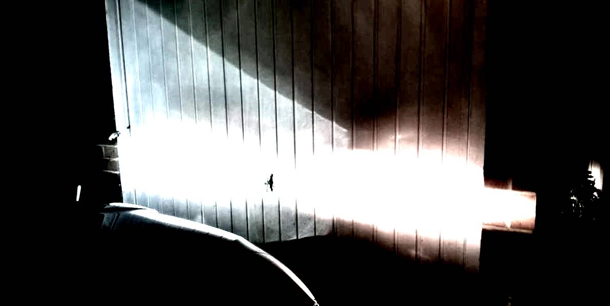

Looking at the picture of the Subaru headlights in post #293, I see how bad they are. It is very clear.
However when I look again at the picture of the H7R HID kit I linked to earlier fitted to a MkIII Octavia Scout I struggle to see the same issues. Am I missing something?
I appreciate a picture up against a garage door is not ideal (the output when viewed as you approach the car from a third of a mile away is more appropriate) the bulb on the left (HID) seems quite close in terms of scatter than the original halogen bulb on the right.
Is the scatter the much dimmer arc of light extending up the garage door?

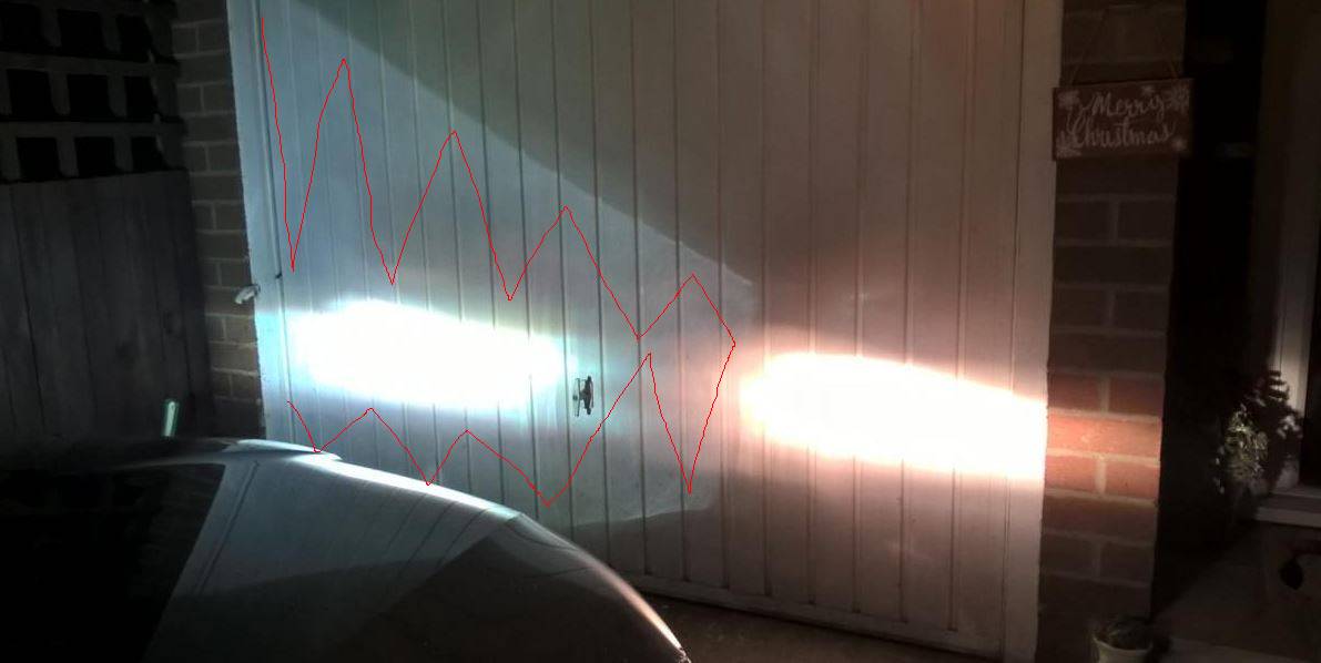

The shape of the beam looks about right although as it has saturated the camera it's hard to see where the hotspot etc actually is. However, it's the area I've marked out in red here that worries me.
That is caused by light that isn't being controlled by the headlight and will is causing glare. I can't see any trace of the same pattern from the halogen even with the brightness/contrast turned up.
If an additional shield designed for the characteristics of these exact reflectors were fitted, it should be possible to get rid of that extra trapezoid and significantly reduce the glare.
