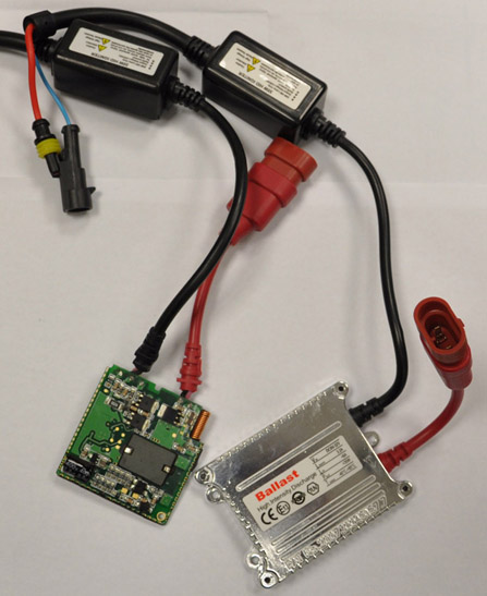

I would be certain that those are non canbus
Non canbus kit has one "Black box" on the connecting wires
Canbus has 2 "Black Boxes"
Thanks - only have the 1 black box so must have the non CANBUS kit.
Mark
