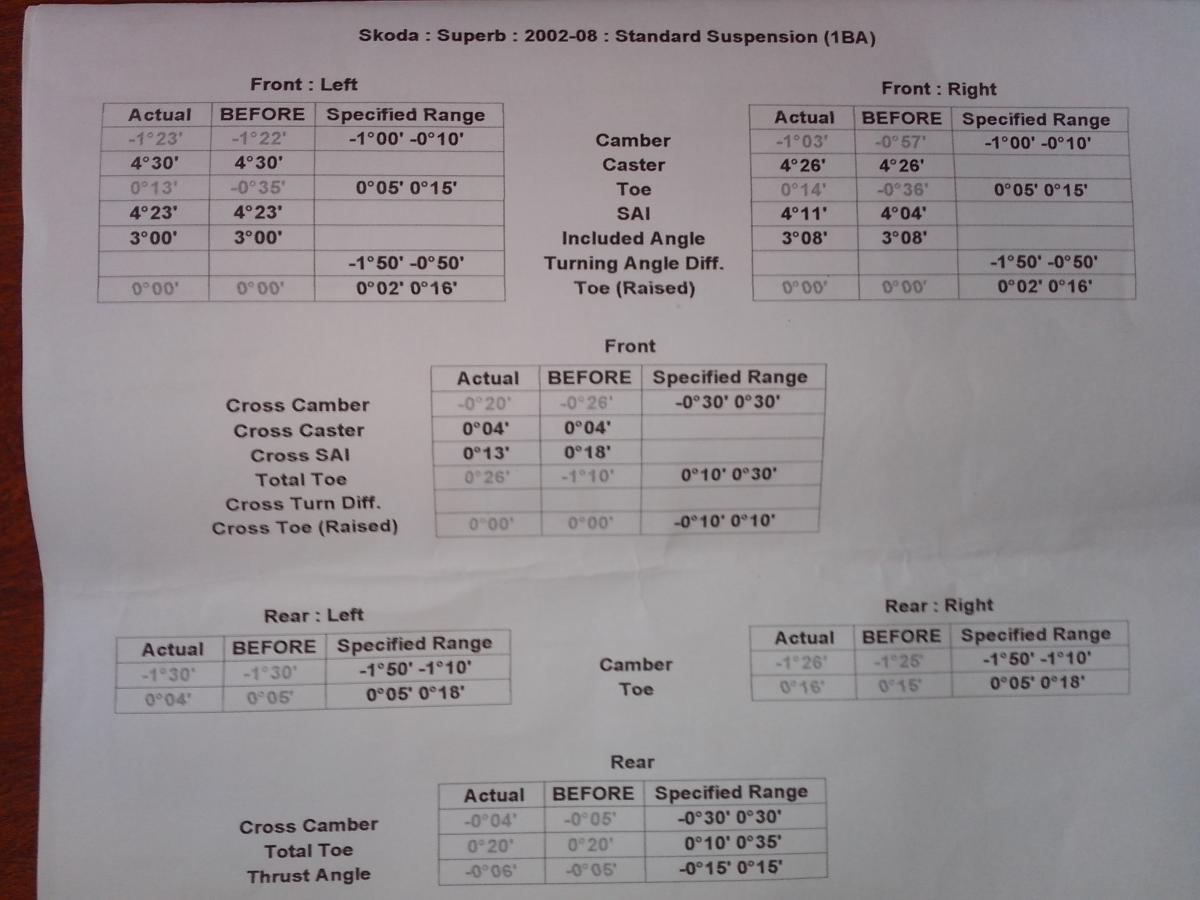

ive had the car on the ramps god knows how many times to check the rear beam and also ive had 4 wheel alignment via a hunter machine about 3 times, ive attached the reading from my last check.

OK, so in static position alignment was checked to be OK (again question, did they check "raised toe" alignment tha tis also needed)
Another question: has the car's track been widened (with spacer adapters), or radically different offset wheels been used? Since wear is on all 4 wheels and on the inside, widened track is one thing that would cause it.
Before adjusting anything, I'd double check all ball joints, with steering at full left and then at full right. It could be you have a play in one or more ball joints that messes geometry up while the car is running. There's a lot of them to check, each arm has 2, there are ones in anti-roll bar and steering rod too..

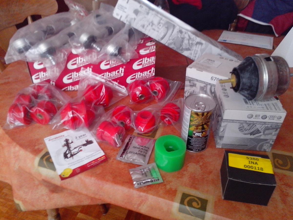

Ok so i thought sod it.! and bought a few things that i thought could do with a refresh -
POLY BUSHES
EIBACH ADJUSTABLE TOP ARMS
ENGINE MOUNTS
SNUB MOUNT
INJECTOR HARNESS
ALTERNATOR PULLEY
COOLANT TEMP SENSOR
THERMOSTAT
CLUTCH PEDAL SWITCH
BG244 INJECTOR/ENGINE CLEANER
DECAT PIPE
still thinking about purchasing the n75, n18, n239 valves, but im sure that if you have deleted the egr you can also delete the n18 and n239 valves??.
Hopefully the car will want to behave after all this :think:
