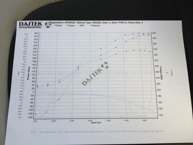

This is a run of a Skodia Fabia that has only had a turbo, injector, intercooler upgrade with a good map, the rest is totally standard and these are the results we got.
357 Bhp and 398 Nm of torque, a bit smoky but it pushes you in the seat.

    I suppose this vRS needs to be put on a dyno that is proven to give accurate figures, such as a DynoDynamics or Mustang. There are a few points to make 1 - The stock GTB2260VK will do around 310bhp

Is that 230bhp at the wheels and 357bhp at the flywheel? Something sounds very off somewhere if thats the case. Mine is about 240bhp at the wheels on the last dyno, but transmission losses on a diesel are negligible so 275bhp at the flywheel. :)

Haven't looked at the map in detail but the figures you say seem good, don't think it'll be very reliable and as said clutch will get eatn but I think it sounds more like a project car anyway.
What turbo are you using for those figures?

AFR is very low, especially at the top end. Any idea what duration your running at 4-4.5k rpm?

Infact think I read the ARF wrong :(
I am new to this but compairing "apples with apples" on a rolling road day it did outrun a 3.0lt BMW and many more, Clutch has been upgraded and is doing well.

Torque seems low, mine is 260bhp but 570nm (423 lbft of torque)!!

The key is the WHP not flywheel figure. As Jason said the 240bhp wheel is similar to his wheel power. Which from a big turbo like 2260vk or bigger along with injectors, FMIC is doable.

398 nm torq = 293 ft lb 293 ft lb at 4472 rpm = 249.4 bhp at the wheels this would be the wheel power on any dyno in the country with this amount of torq
so how do you boost this to 357bhp ? i mean MAHA dynos hav high losses but they also give rly rly low wheel figures
you can add around 25bhp to the wheel figure
so you rly made 275 bhp

goin by your calculations darkside have 400bhp :)

The car is mine, It is in daily use, and all the power is used daily too ;)
Performance specs are as follows:
Standard unopened pd130
standard 6 speed box
exedy uprated clutch with solid flywheel
custom injector nozzles from united diesel
seat sport front mount intercooler
4 bar map sensor
straight through 2.5 inch stainless decatted exhaust
mapped by the best out there.
