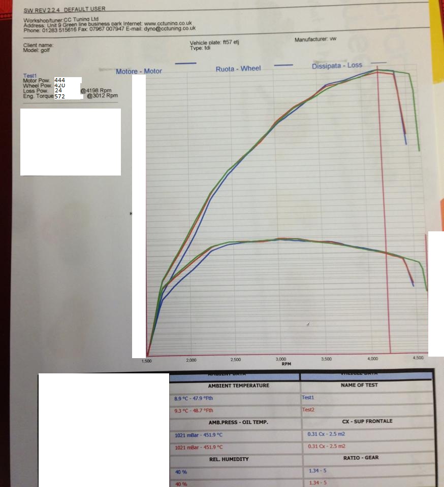

823408_10152544015555162_2088118423_o.jpgas you can see
250 wheel power
340 max power
at 4500 rpm
now lets move up to 4800 rpm
240 wheel power
357 max power
thats an increse of 27 bhp in just 300 rpm
please explain this bull how can teh wheel power fall and the max power keep raising ?
you have a 280bhp car at the most MAXIMUM

    I suppose this vRS needs to be put on a dyno that is proven to give accurate figures, such as a DynoDynamics or Mustang. There are a few points to make 1 - The stock GTB2260VK will do around 310bhp
1 - The stock GTB2260VK will do around 310bhp if you ignore EMPs, the 3.0 Tdi guys are struggling above 320bhp.
2 - To get anywhere near 300bhp you need a camshaft or headwork. There is not enough airflow above 270bhp on the 8v Head.
3 - Without an Injector Lobe change on the camshaft, Injectors with any larger than the Firad 80%s nozzles fitted results in a massive loss of pressure in the Injector body, meaning poor atomization (white smoke at idle, black when under load), not nice on a daily driver.
We have done a lot of experimenting with this setup so if these figures were possible I think we would have it. With the exact setup and a race cam, just over 300bhp was achieved without NOS and acceptable EMPs and EGTs.
We are planning a Dyno Day very soon. This car can go on free of charge and you can watch what we do with it.
Thanks
Scott

dyno runs can be manipulated. the transmission losses for a standard mk1 Fabia vRS seem crazy high. the criticism will be down to 'alleged' (I know who I believe) history
Absolutlely.
I have extensively used a dynomite dyno before to tune my other car - which is a never ending sorry, something simply like correction factor temps or ratio can change the figures, as long as it intersects at 5252rpm
Edited by ajs_vrs
It is very difficult to post this without being totally shot down but some of you guys were correct with regards to the figures we posted. In my defense we paid our money, along with many other enthusiasts, to get a honest dyno run, but since then we have found that the figures we were given were incorrect. We have since returned and done a rerun and found we were about 40 Bhp down. Should we ask for our money back, or realize that all dyno runs can easily be fixed.
