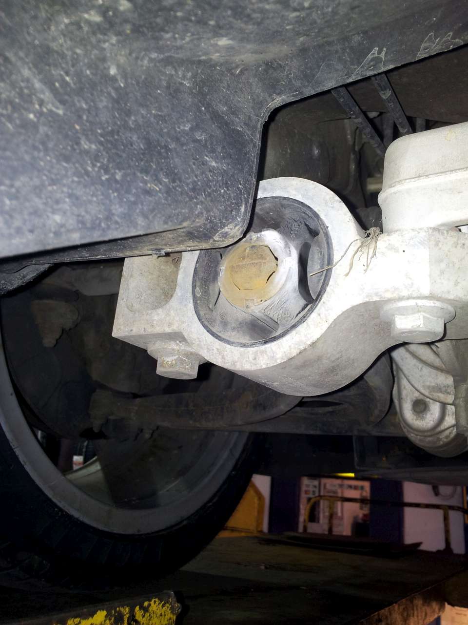

I had the car independently looked at today - an ex skoda master technician.
He immediately spotted this torn bush on the front.
" SKODA " should never have tracked this up - complete waste of time.
Opinions ?
He's right. That will allow the steering geometry to change as you go down the road. BMW E46 3 series are bad for this. Mine was awful until I renewed the them.
Get the offset super pro polybush ones then you can adjust castor til your hearts content.
The plot thickens.
Opinions ?
Yes, complete waste of time. No point having an alignment done with a bush in that state.
