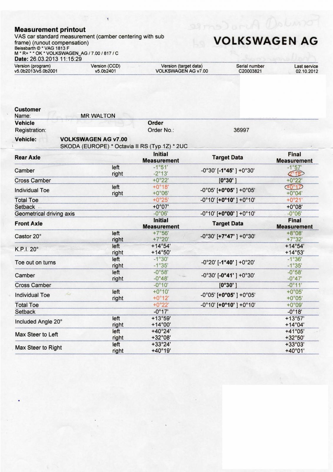

I have however had this done today - what on earth does it mean.
I can say the rear has NOT been adjusted because its seized up and ive been told i need new control arms and lower arms ( rear )
I have been charged the full price for the job even though the rears were not altered ? - is this normal.
Is the data target current ?
Some things in red - no doubt this is still going to shag my rear tyres ( and maybe front )
So 500 quid on tyres, 70 quid on alignment ( or not )
and still in the same position...
What does it all mean ?
HELP

Your rear toe and camber are still out, so yes, it will ruin your rear tyres.
Take it to an indie with a Hunter rig or similar and ask for an opinion in regards to seized components and if you do need to replace the arms.

Well they've sorted the front although is wasn't all that bad before. Had the fronts worn on the inner edges too? It didn't look all that bad to do that excessively Maybe the front and rears had been swapped over at some point.
At the rear the camber is a bit out. the wheels are leaning in at the top a bit too far. This is why it's worn the inner edges. The left toe is also a bit out so the wheel is turning inwards a bit at the front.
