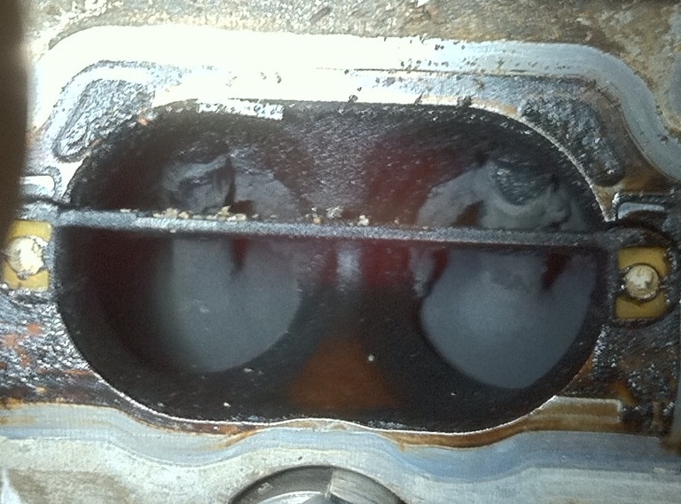

Removed the intake manifold (a fairly time consuming job) and found the inlet tracts were gummed up to buggery. I have posted the pictures on here before. 2 tins of carb cleaner, 2 roles of kitchen cloth and 4 hours of careful cleaning later I put it all back together (another couple of hours). The problem has now gone completely. I've done a further 5k since with no reoccurrence.

  • I'd guess at a coked up inlet manifold.
This should be nice and shiny, but it's covered in oil deposits. Sea foam or the like won't touch it - there is just too much of it. The first thing I noticed when trying to diagnose the problem was how oily the spark plugs were - Even the new ones I put in oiled up quickly. This may be a good tell tale to look for. The inlet flaps were also covered.

So, more research has been carried out by me and these symptoms are also seen from clogged intake valves and seems to be a massively documented issue, especially in the USA where the octane fuel they use it lower and does not burn as clean as our fuels, but still at about 60-80k even if a TFSI engine has been run on Super Unleaded all of its life it will still need de-coking.
These intake valves can be got at by removing the inlet manifold which with patience can be done in just under an hour. Here is a great PDF explaining step by step how to remove the inlet manifold (the PDF is for the K04 turbo upgrade kit but the first section is on removing the inlet manifold) - http://www.vividracing.com/catalog/productdocs/STaSISMTF0turboinstalltransverserev7_2.pdf
In this thread from another forum it shows the extent of the problem with before and after pics of the cleaning - http://forums.fourtitude.com/showthread.php?5493383-Intake-Valve-cleaning-at-77K-(Insight-amp-Pics)&p=74829604 - Also tells what tools they used to clean it.. Mainly stainless steel wire bushes, compressed air and small picks...
