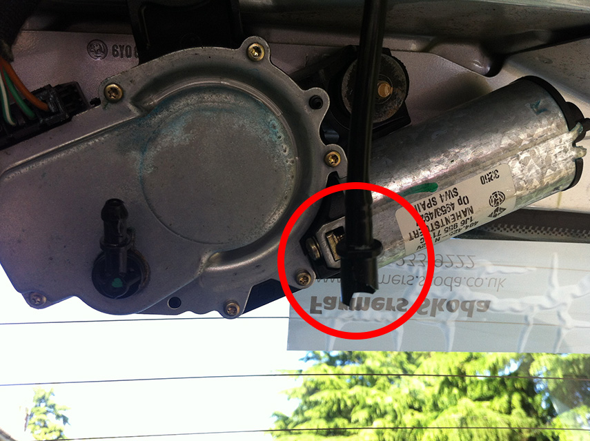

For some time the rear washer jet hasn't been working in our Fabia. Initially we thought it may have frozen, but turns out it had been leaking into the boot lid(!). Upon inspection the plastic joint has cracked where it joins to the motor. Does anyone know where I can get one of these from or know a part number I could give to Skoda? I gather this is a fairly common part across the VAG range?
Picture to illustrate!

Hatchback = 1J0955875
Estate/Combi = 1J0955665C
Best to get the chassis number and get it from TPS to guarantee the correct part.

Thanks for the tip! Yeah, I imagine the part will be a couple of quid hopefully. Much appreciated in digging the part number out, it's hard to be descriptive on something so small!
Here is a link to getting the part numbers yourself http://vin-online.ru/ (if you want) it is in Russian but you can get almost instant translation to English (well I use google chrome and it does a translation) and it's very helpfull.
