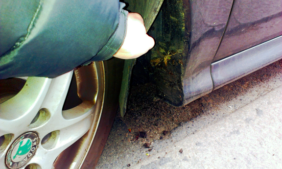

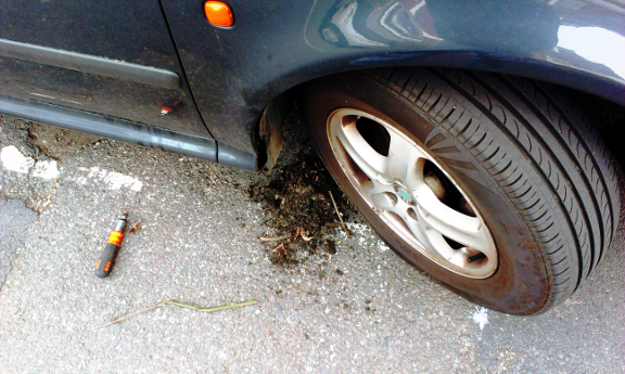

Well, I've done a quick clean out behind the front wheel arches. I found a lot of mud etc. there. I hope this is the solution I've been looking for.Take a look at the photos. What do you think everyone?Mark
Blimey. You have some free compost and better MPG if nothing else ;)
Nice compost factory!
If you have water appearing on the door seals (as per your pictures) then I would suspect the membrane in the doors is part of the problem. The compost is a very common issue though and causes water to leak through as well though.

Mud from wheel arch , hope this sorts my damp problems , pic is on it's side
