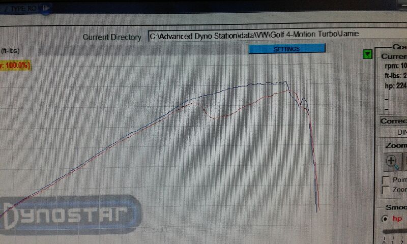

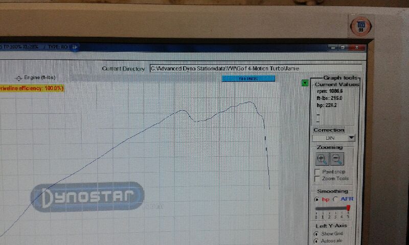

Got a text from Wayne today, he has sent me a picture of the dyno graph but cropped it so that all I can see is the graph, it is a lovely smooth curve I have to say but I have no idea what power he has squeezed out of the Golf.
 I guess I will get to see the numbers when I pick it up.
 It hasn't been simple, it took hours to eliminate the fault codes for the items the engine no longer has and he has spent an hour or two this afternoon perfecting the curve as it had a dip at 5500rpm, this is from the variable valve timing, after an hour I got a second text with a lovely curve  :happy:
Great news :)
Charts.
With the dip
Dip cured  :happy:
Now we just need the scaling! :D
Does that say 224hp?
I can also see 100% drivetrain efficiency! which confuses me! especially with a 4x4.
