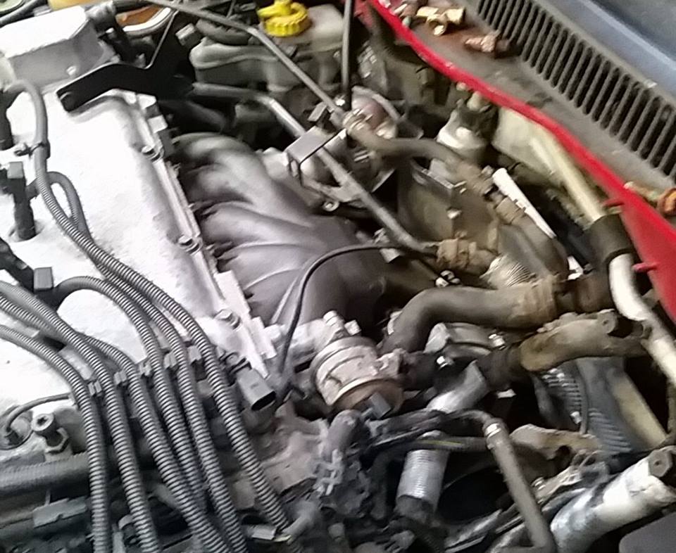

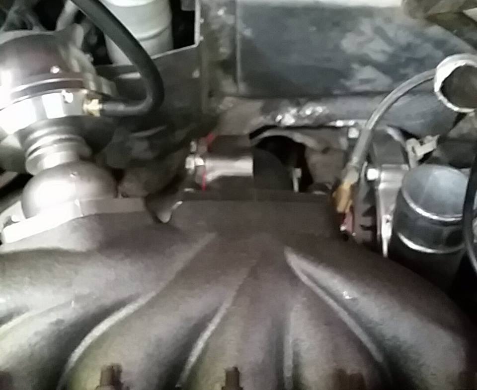

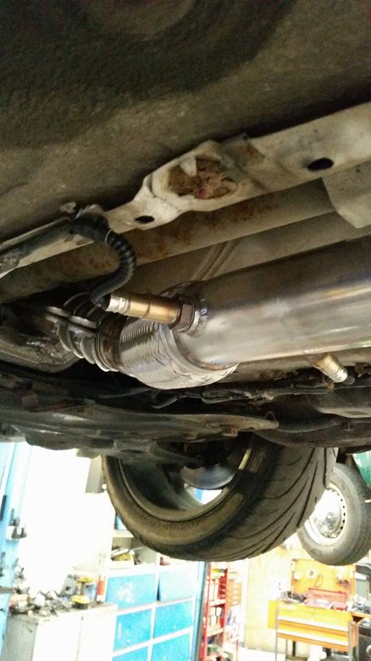

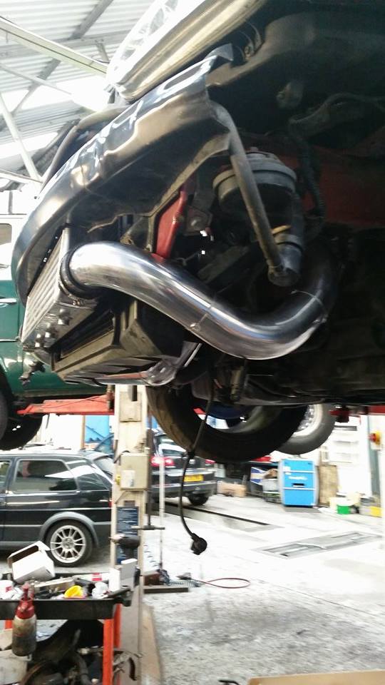

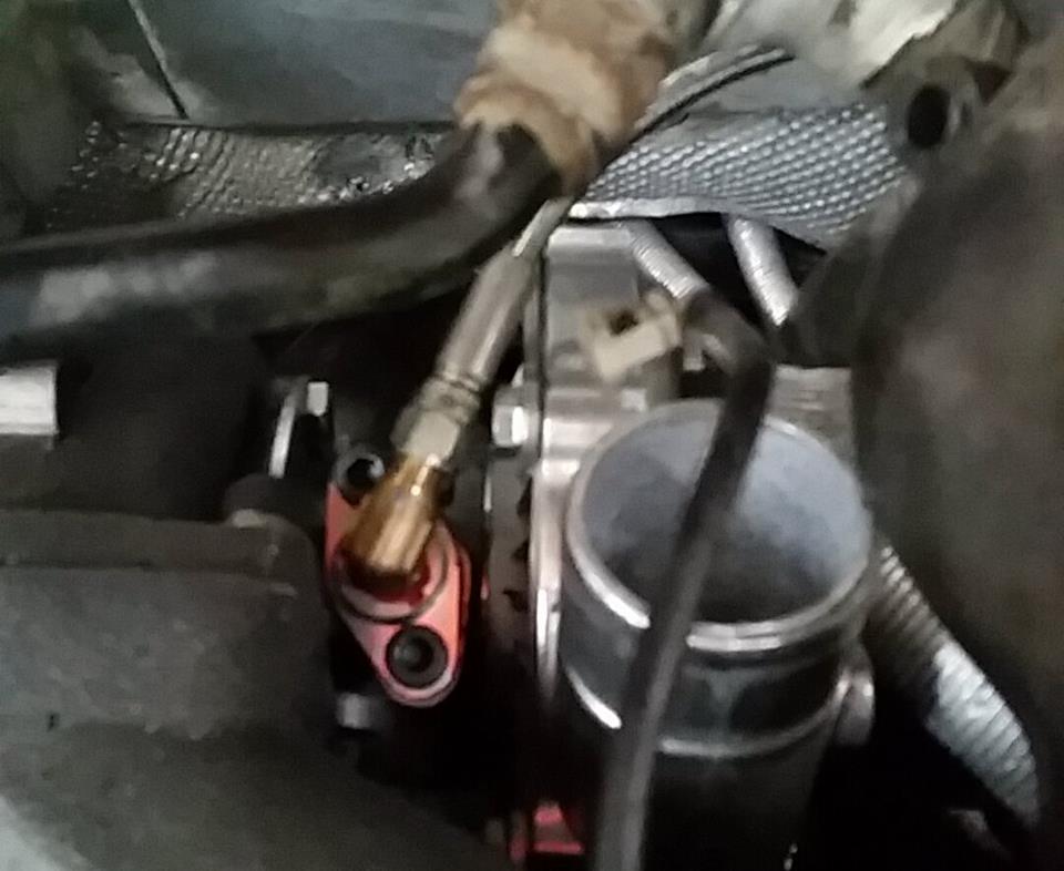

Had a few minor hick ups, like the inlet manifold and exhaust manifold being wrong, so now about £500 lighter but have the correct parts
Progress, it is now Friday night, car has got majority of bits bolted on but has not been fired up yet, tomorrow is the set up and modification of the front bumper to fit back on.
 Pictures (not taken by me)
