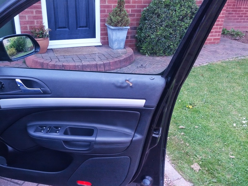

Just bought this lovely VRS but the driver's door card has some damage.
Can anyone suggest what I could do with this? I'm looking around for door cards on eBay but there doesn't seem to be much.

Very common, they all do it eventually. I would try a scrapyard for a replacement, although finding one without the bubbling is going to be difficult.
One tip, never drive using that part of the door as an elbow rest.

For much less than £400 wanted by a dealer and probably less than £250 from scrappers, you could likely get all 4 retrimmed in something suitable at a decent retrim company.
If they can do a leather dash, they can do anything the door cards throw at them.

My June 2011 build Octy vRS has done this... I was just gonna get the top of all 4 doors done in a black Alcantara or suede. Fixes the problem of it ever happening again, as the suede can stretch/flex whereas the OEM vinyl can't.
Also, will look much better too...
All up I was quoted AU$500 for the lot from a pro trim shop. :)

I seriously doubt it would be a warranty issue as it is effectively damage caused by misuse, and something that has not failed because of manufacturing defects. It is certainly not an issue with just the OP's car, it is across the whole range, and short of a global recall to replace, which they won't do as it isn't a safety issue, it is a issue that they will say is avoidable and purely cosmetic.

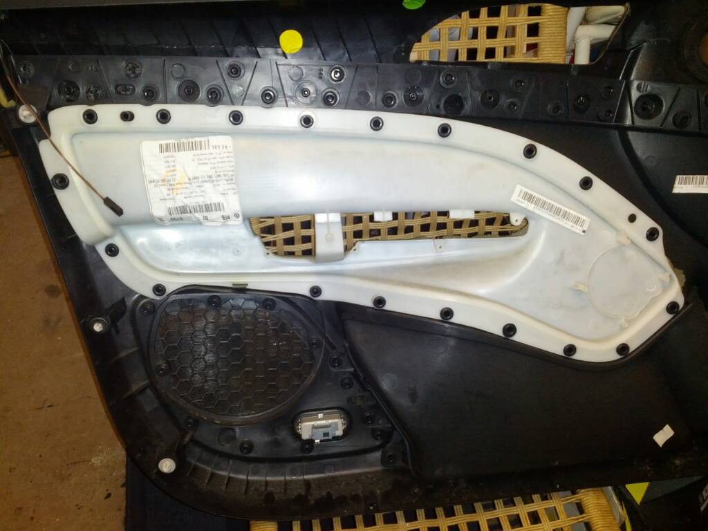

It seems like the best way is just to remove the top bit and swap that rather than the larger leather or fabric bit in the middle.
Those plastic welds are a pain though. Not sure on the best way to remove and then resecure.

I don't agree. If you swap the panel in the middle you are not compromising the strength and rigidity of the door card itself. Its only a 15 minute job to swap the panel over.
Mike
I might call on your assistance again here Mike! I've got a set of leather vRS door cars in the garage and wouldn't mind changing that section over.
Mike
So just the white part?

Makes sense. The problem is, I need to change the silver insert over too. So I think to get to that I need to take the top bit off.
