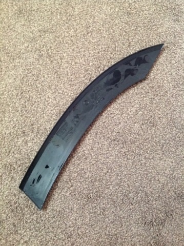

Well to continue this saga I can confirm that the Skoda supplied adhesive sticks brilliantly to the car bodywork but not very well to the plastic arch trims. When I took my Yeti in for service and MOT at a new dealer, I did not realise it would go through a carwash, previous dealer did it by hand. Anyway two parts of the trim had become loose. It should have been car wash safe after 10 days anyway. I made sure I degreased the plastic trim, but I think it needs more than that, a course abrasive to key the inside surface should help. So I have a nice impression of the trim now with inner marking. Anyone got any tips for removing P1 adhesive?
Perhaps you should try some polyolefin primer on the plastic parts? Something like the Loctite 770.

No I used the Skoda parts, the P1 adhesive and primer. Might give Tigerseal a go though when I refit as it is a lot less expensive, just trying to track down the polyolefin primer that their technical people mentioned when I asked if I needed a plastic primer for it, although there product pdf does not mention needing it, but I'd sooner be on the safe side. I'm also tempted to try some 3M double sided panel tape instead, the really good stuff does not seem to be very available in the UK, only the US. I don't want to do this more than twice, one too many times so I might just do a test with different products first on just one section to see how difficult or easy it is to remove.

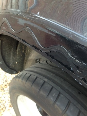

Jeep this is what mine looks like after the third attempt of affixing using the Skoda adhesive and, may I hasten to add Skoda approved fitters.
As previously mentioned the glue adheres to the metal work but not the plastic.

From experience, from an ex-employment of mine, it looks like the plastic was not "keyed" and still had some of the releasing agent on it. Meths actually isn't a good cleaner in these circumstance, and it really needs a specific cleaner, such as the Wurth product I mentioned earlier, or even their Acrylic solvent.

I could do with the two rearmost sections, as in picture 1, to cover the rust spots on my rear wheel arch!! I think it is going to be the only easy way to cure them.

From the research I've done it seems most people cut it off with a sharp blade pressed flat on the paintwork. I'll first try heating it with a hair dryer and using a sharp plastic edge. Glue removal attachments for drills seem to work quite well without damage to paintwork for the remaining film of adhesive.
I'm not sure how fussy I need to be with the remaining adhesive though, as I plan to recover the arches, I'll not be beaten on this. I'm very tempted with the double sided route also, seems 3M does the best stuff, but there seems to be counterfeit products around, and I can't find a source for the premium version in the UK, plenty from the States though.
