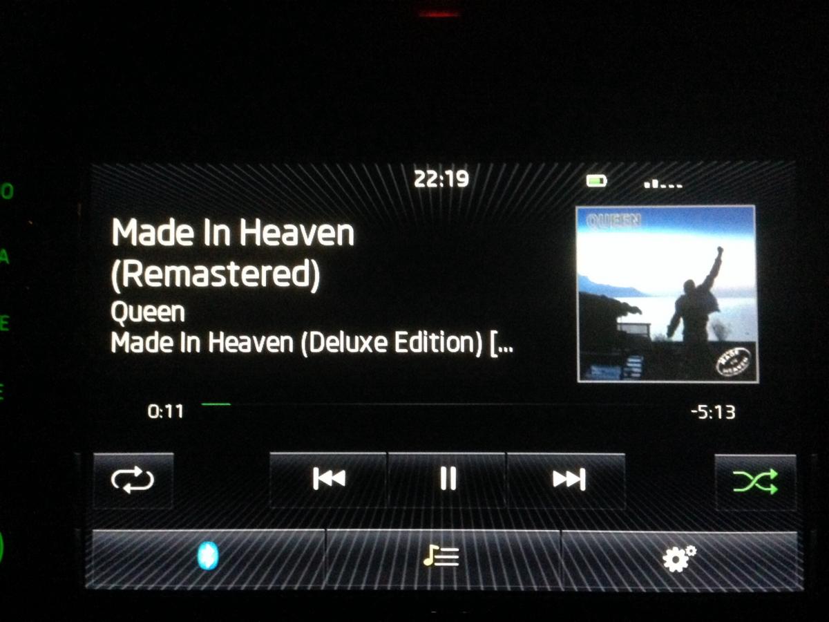

What head unit do you have? My Columbus shows art work via the Bluetooth connection to my phone.post-67678-0-53618500-1384454567_thumb.jpg
What head unit do you have? My Columbus shows art work via the Bluetooth connection to my phone.attachicon.gifimage.jpg
Just standard.
