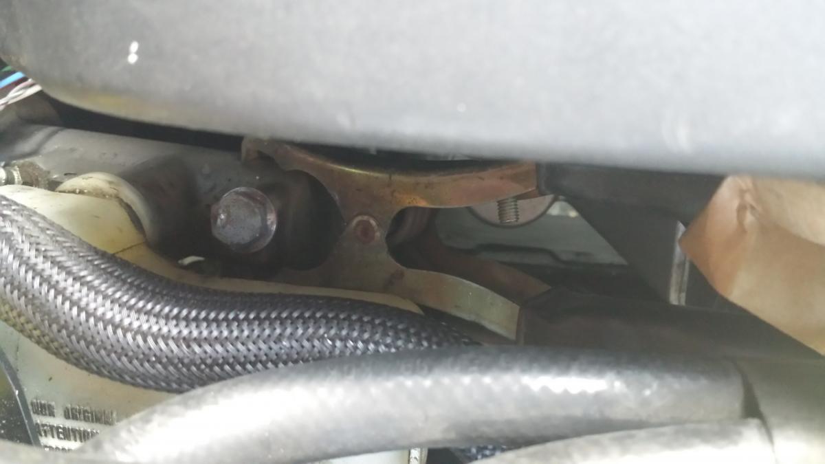

Minor disaster, Sheared the brake master cylinder forward bleed nipple, did the oooo that's a bit tight, just a bit more...think it's going....tink!!! damnit Jim!
More major disaster, sheared an easy out off in the bleed nipple! Broke my own rule......never ever use an easy out in a brake nipple,even a snap-on one ....never ever works!
What you need is a mate with a mig.... no not the Russian jet
HahAAAAA! I have one just like that! Cheers J!!!
Thank god was having mastercylinder replacement night mares!!!
Success!

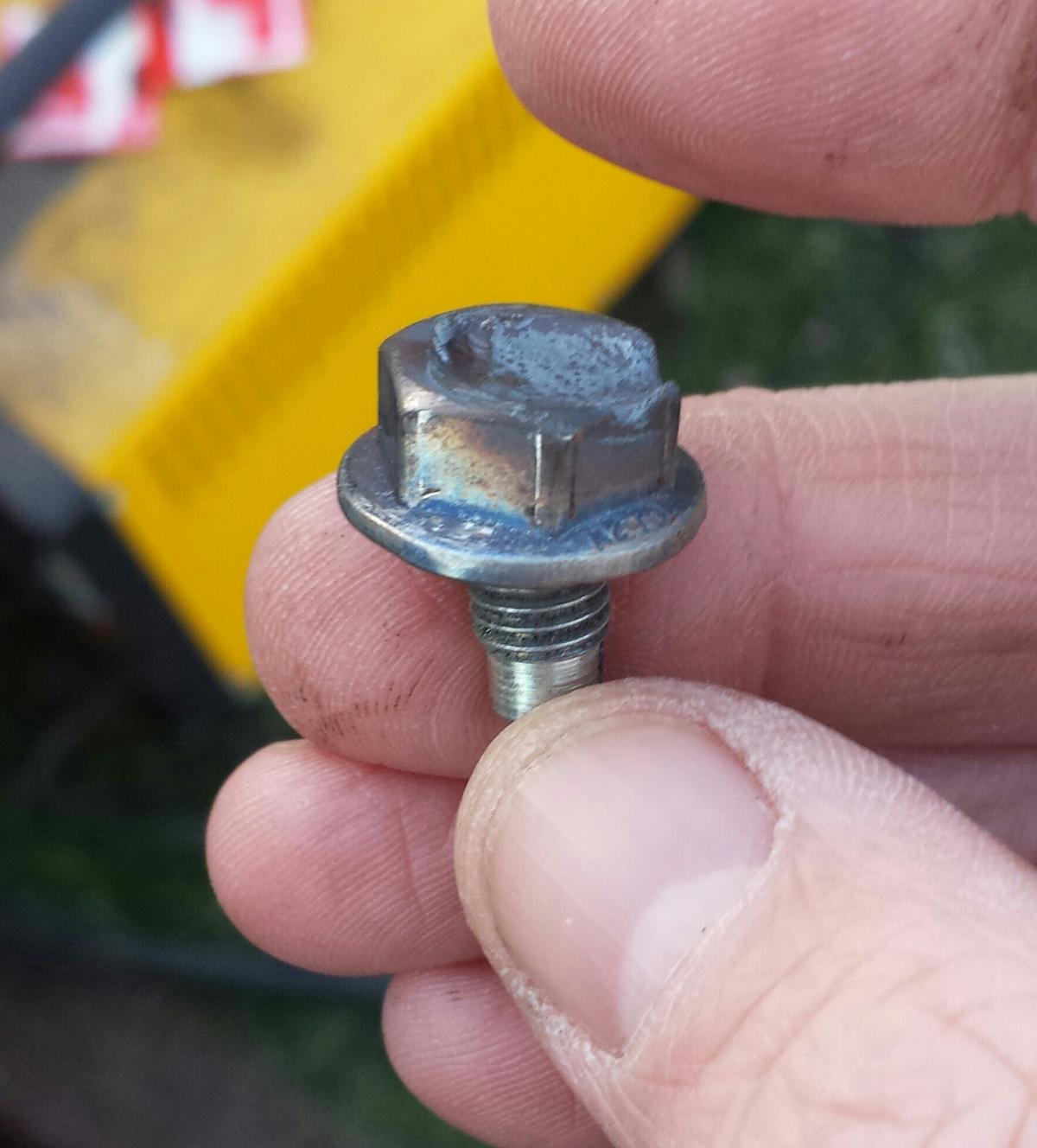

Some bigger Images from nitrovrs.........
I didn't hold it that square but it was tricky with so little access............
post weld, went with a satisfying little snap!!
