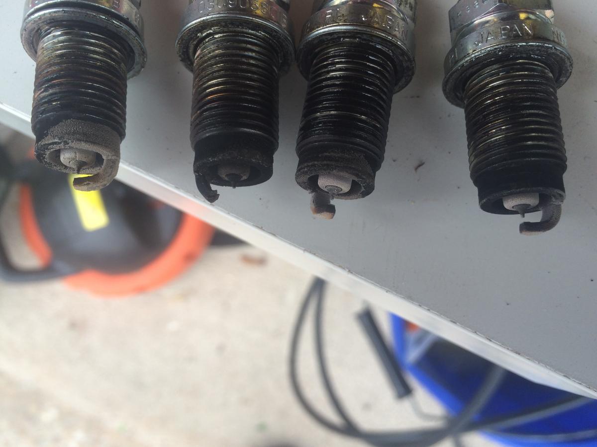

  • Here's mine today when I removed them for compression test, 11,000 km on them currently. I think they can comfortably go to 20K (km) ?

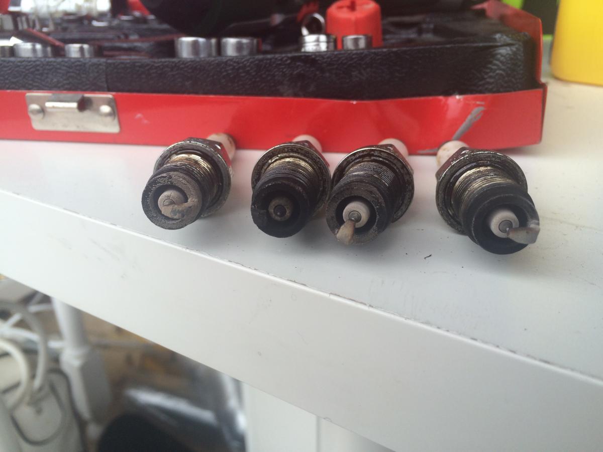

These are the plugs from left to right (oil cap to battery)

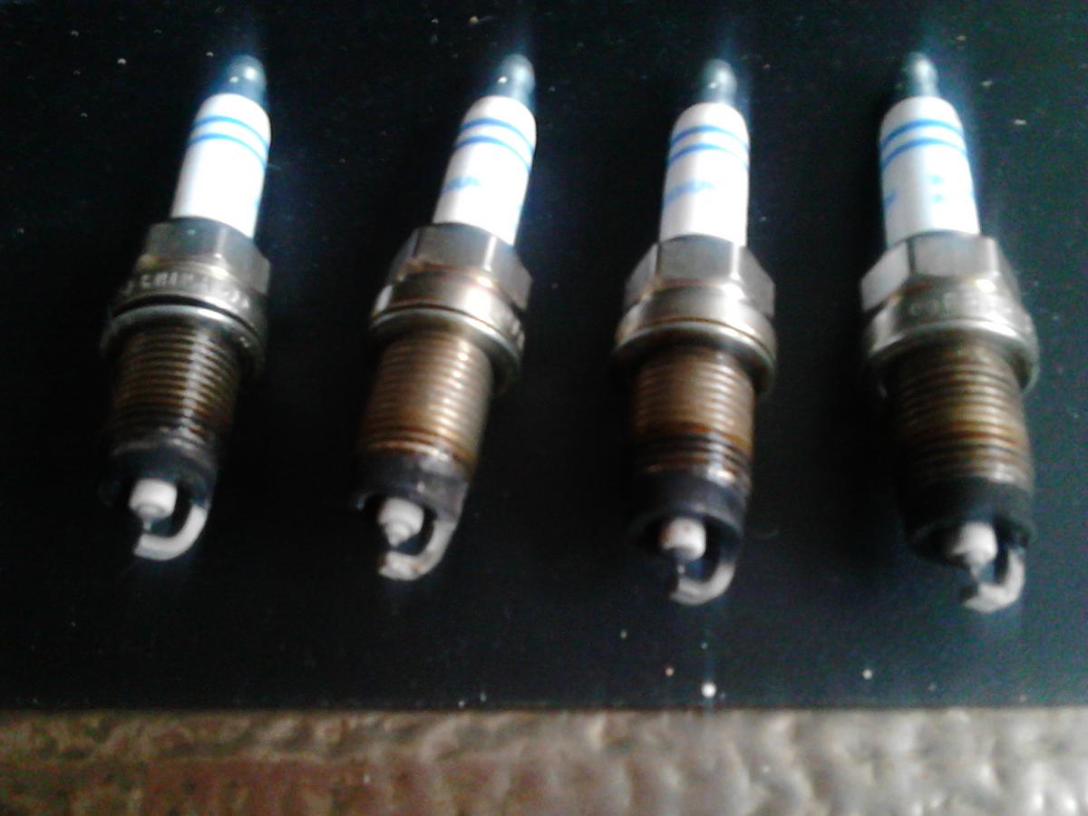

Took these out last night. Think ive got issues....
I think for these engines yours are looking healthy

I think you have what spark plugs taken out of a 1.4 TSI / TFSI Twincharger 132-136 kw Minimum often look like.
That is the issue that is the reason VW have stopped using that engine in VW's, Audi, Skoda but still in the Seat.

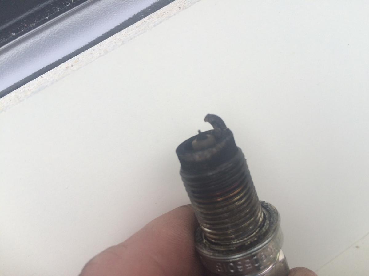

What plugs are they?
Chappers777,
So just as expected when the one plug goes.
Looks like maybe went too far burning out and a part has broken off.
Type that spark plug Part Number into Google.
That is the 'Long Life' plug that VWG Dealers use.
