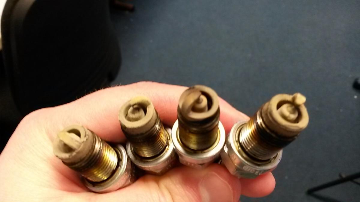

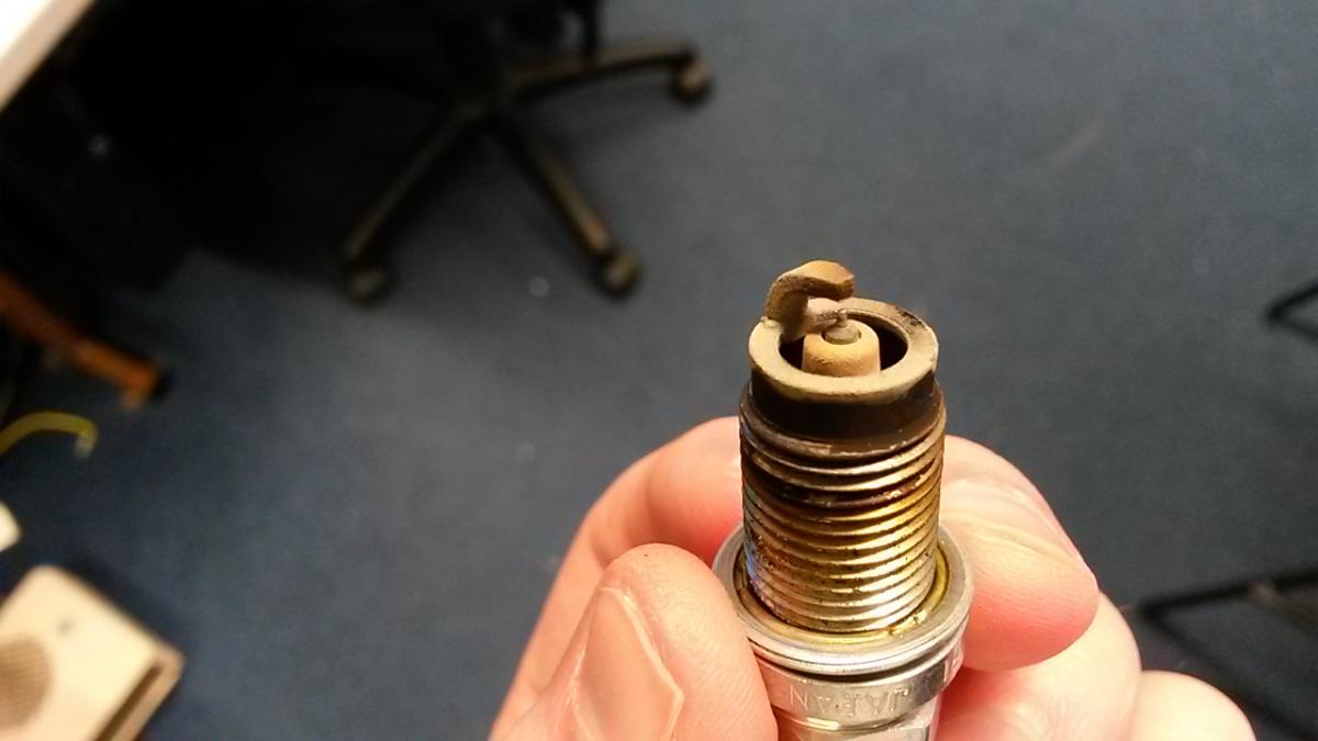

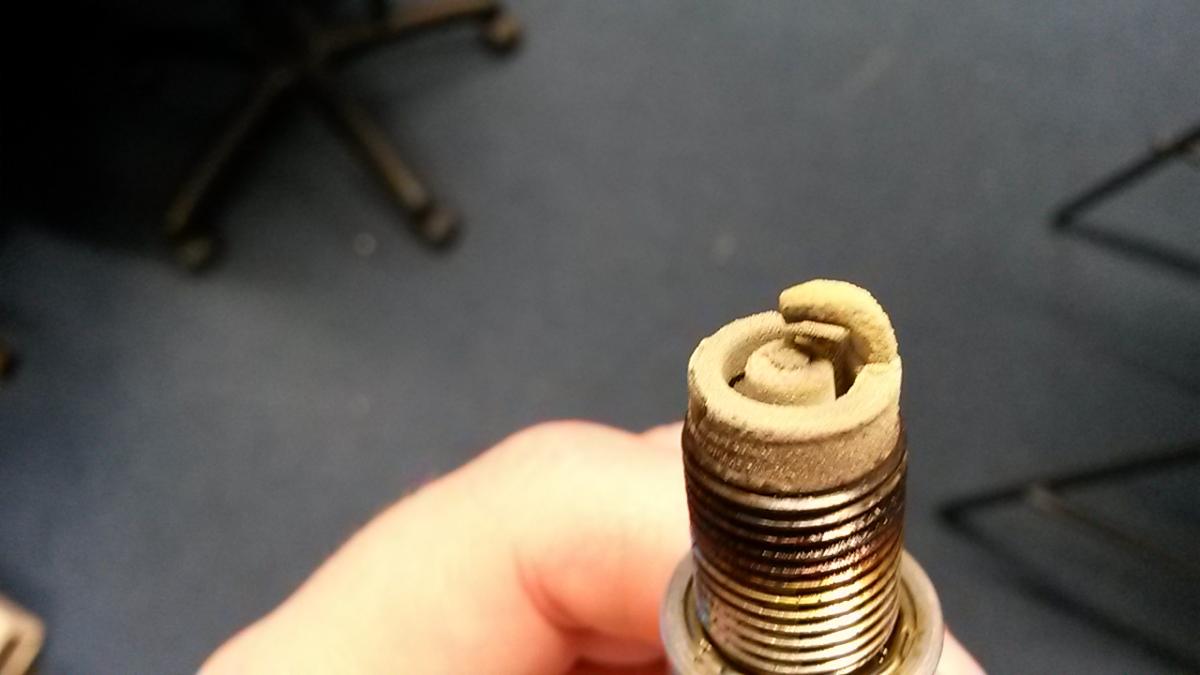

  • Here's mine today when I removed them for compression test, 11,000 km on them currently. I think they can comfortably go to 20K (km) ?
These have just been pulled out of a 2013 VRs.
These are the original plugs. 34k
Unfortunately, i didnt make a note of what plug goes where.
Look pretty similar to ones pulled out of CAVE engined car at 27,000 miles IIRC.
It used to use about 1L of oil every 2-3k miles.
Mine doesn't seem to be an oil drinker. I check every other week.
Used around 4ltrs in 34k
Edited by mdking

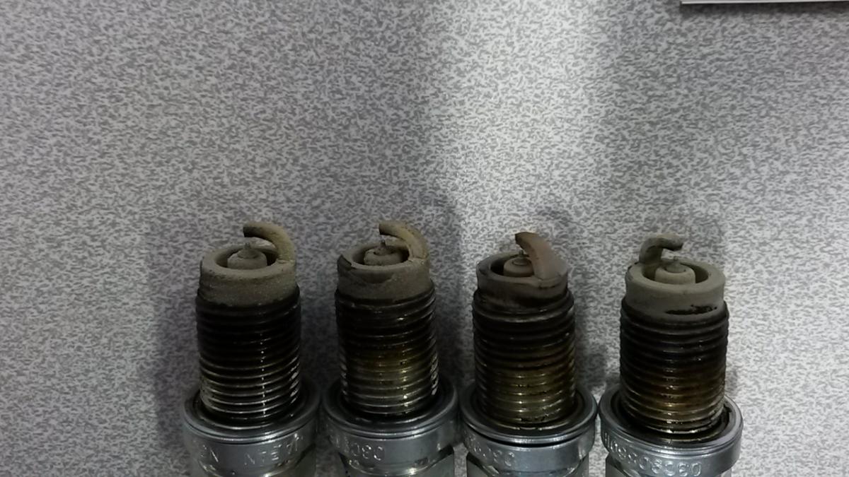

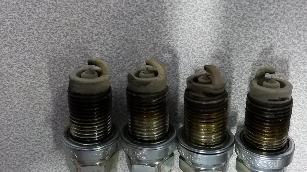

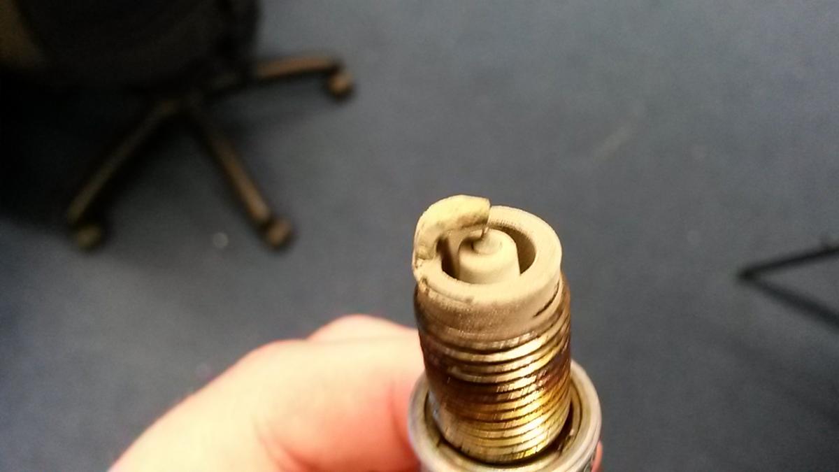

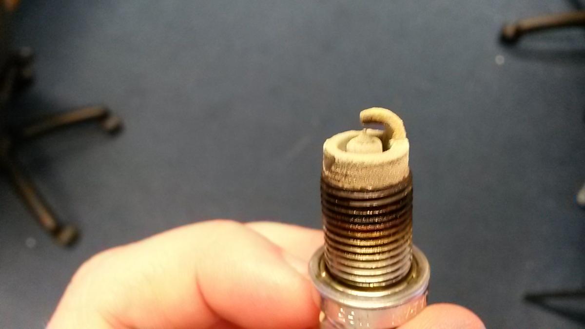

The third photo, of the single plug seems to be a very different colour from the others, is this down to the use of flash or something?
Did you remove the plugs as part of a routine service (34k miles) or because of a perceived problem?
Could of been the light. Hopefully these are better
They all look like a consistent colour.
Look good IMO.
