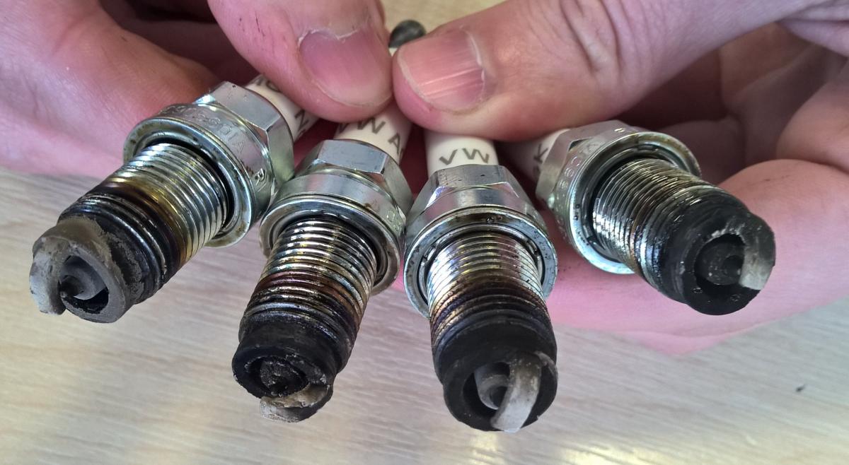

Had my original OEM plugs replaced today- ~20,000 miles, 3 years old and moderate oil usage.
Looks to me like a combination of Oil and carbon fouling?
Never had any misfires that I've noticed, occasional lumpy idle but generally performed as expected.  Initial impressions on the new plugs are slightly smoother and more willing to go!
Not bad.
If you have a feeler gauge check what those taken out are now at.
Second from the left is the worst, I;d check compression on that pot first and then do a blow down test
