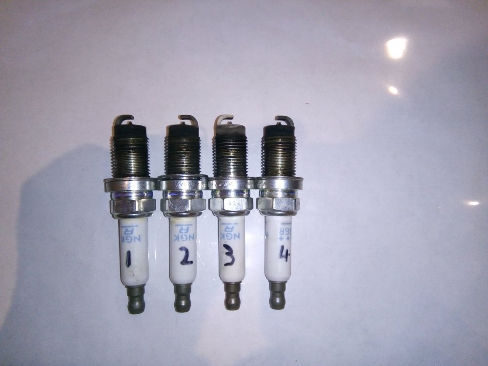

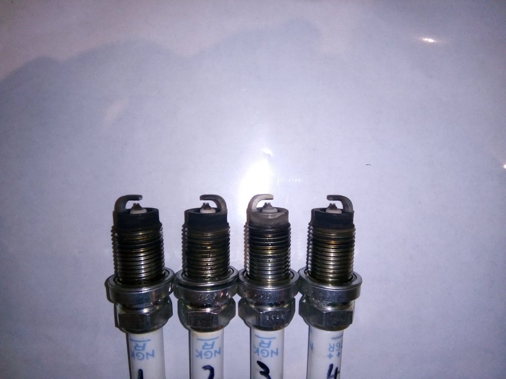

  • Here's mine today when I removed them for compression test, 11,000 km on them currently. I think they can comfortably go to 20K (km) ?
I have bumped the Plug thread, but i have not used those plugs, so can not comment on gaps.
REVO Map beware as far as i am concerned, so please let us know what the plugs look like
& what REVO tell you to set the gap at.
Best check with them.
