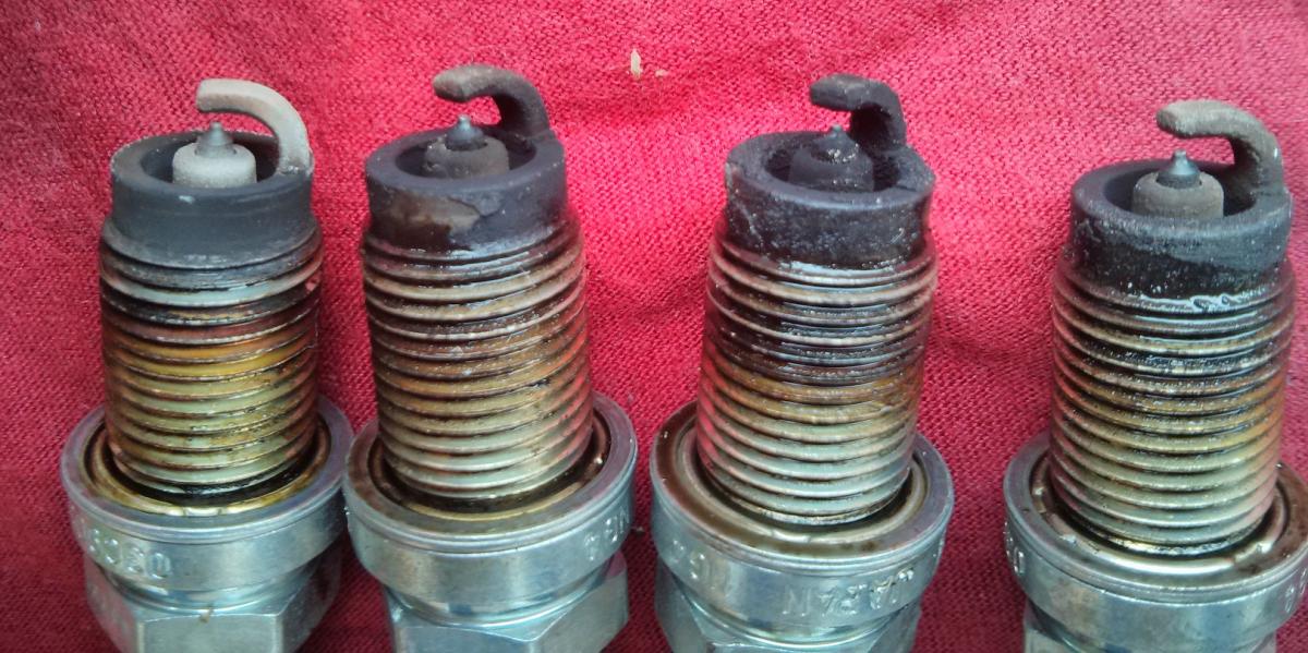

This is how they old ones look (From left to right > 1 to 4). The infamous no.3 looks normal I think but no.1 is too white, which I'd read is an indication of...?something not very good anyway.

it looks like 1&4 are from a different engine that 2&3!!
1 (left) is running waay to hot and you have detonation in that cylinder - ceramic insulator completely white with pock marks on it (uneven, like chickenpox scarring)
2 is running rich (and cold) and is burning little bit of oil, running too cold
3 is running very rich and burning lots of oil and it looks like the best culprit for misfires, running waay to cold
4 is the best of them lot, temp looks ok, a bit too rich and it eats a little bit of oil

I would say the Plug Second from the right in the picture, came from the Cylinder 2nd from the left as you look at the Engine when you open the bonnet.
The one that gets oiled and cooked. & fails.

Might drop by the dealership, show them the plugs and ask them to do a test for oil and compression if I can bother. Or else I will just proceed with a replacement sooner than I thought, this has been on my mind for a while for several other reasons. Car has been using roughly 250-300ml / 1000 KM and for the last year it's only done tiny commuting while cold so I don't know if it's related. It will depend how much free time I will have in my hands in the coming weeks.
PS. The plugs on the picture are from left to right 1 > 4, if that gives any extra clues...

This is part of the problem, you'd show them the plugs and they would not know what they are looking at, a plug is a plug, not new and shiny? what do you expect, came out from an engine.
What I am trying to say it is a lost art to correctly read spark plugs and arrive at diagnosis and then apply an appropriate solution.

Do you think the look of those plugs, being in since 2011 (factory) and having done 45K km is so alarming for a 1.4 tsi twincharged engine?

Your plugs are healthy, no damage to them whatsoever. They will not fail any time soon, the old ones. Having seen them one can see what is going on inside the combustion chamber during combustion stroke which otherwise is really hard to glimpse, but has been done on specialist test beds. However, plug 1, one outmost left would indicate detonation and this will lead to engine failure on that cylinder, piston will be eaten away - hence suggestion of bore scope diagnostics.
