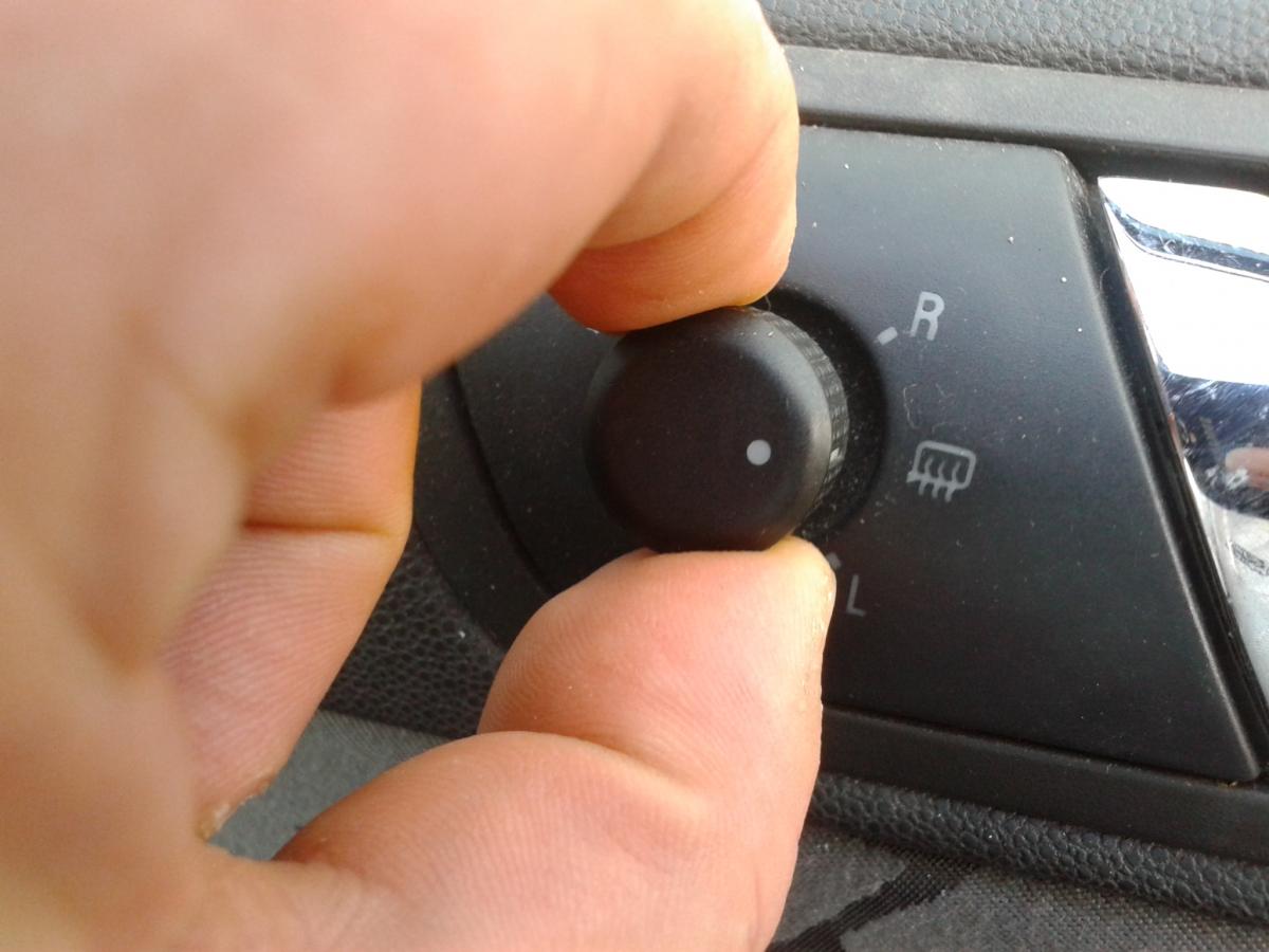

I am trying to sell my fathers Skoda Fabia 1.4 Elegance Estate 2002. I must fix a few things first, and one of those things is thet the electric wing mirror adjustment button is broken off. Ive managed to get hold ov a new switch, but am i able to change it myself? I am not in any way a mechanic.
Do I need to disassemble the door to get at the button panel, or can i whip it out using a tool? Do i have to disconnect the battery?

Sure it just pops out and unclips. Can't you work it out from the new one where the clips are etc? Don't need to disconnect battery either.
Button panel comes out the front. Thin tool in the seam behind it to push the retaining clip, rotate towards the front and pull out. Usual worry would be breaking the clip. Not too much of an issue as you're replacing the whole thing. Second worry is DO NOT LET THE CABLE SLIDE BACK INTO THE DOOR when replacing the panel. Otherwise you may end up stripping down the door trims to retrieve it.
the actual button just pulls off so if the switch still works, just swap the buttons over :)

I think if you pull the handle, you can lever something sharp in behind to pop out the actual whole switch.

it just pulls out, removed mine the other day while changing the wingmirror over. I just levered a trim remover tool (although a screwdriver would work as well) on the top side and it just popped out, didn't need to mess with the handle or anything, and to be fair I wasn't that delicate either.

I changed the part in less than two minutes, thanks to your tips! Now its working perfectly!
