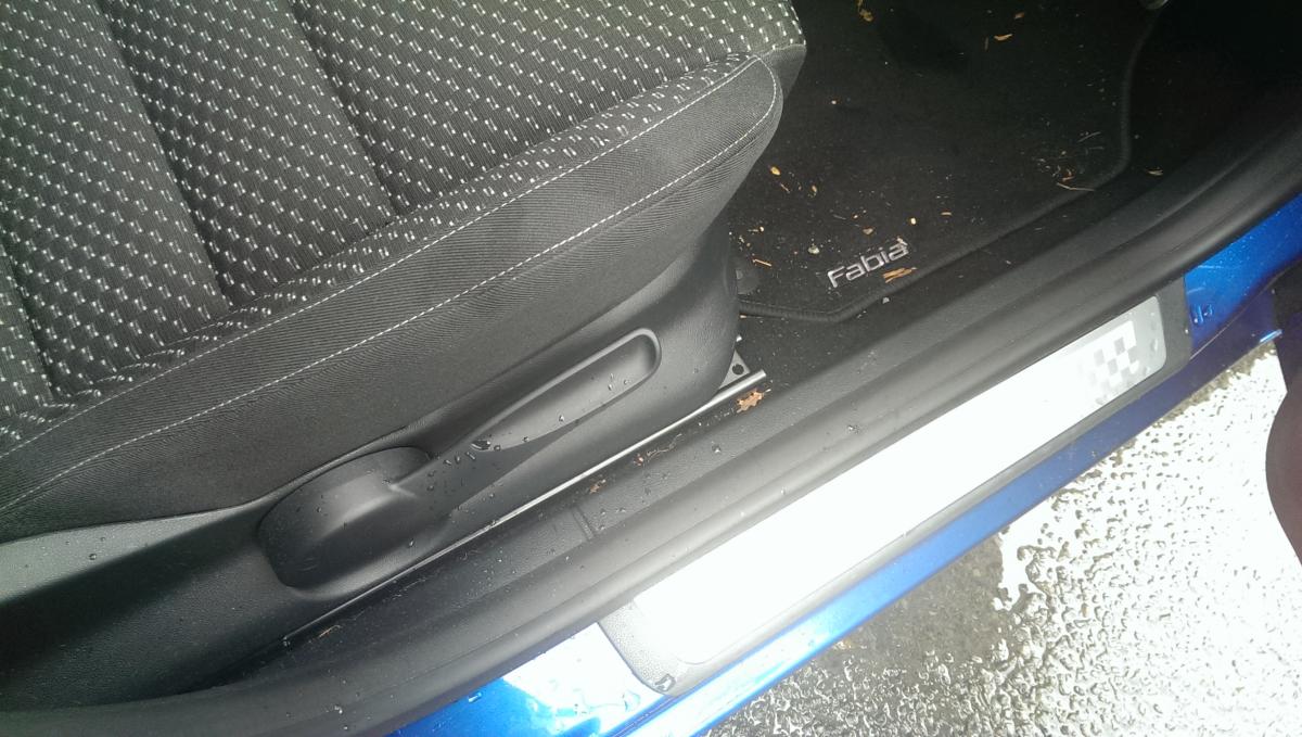

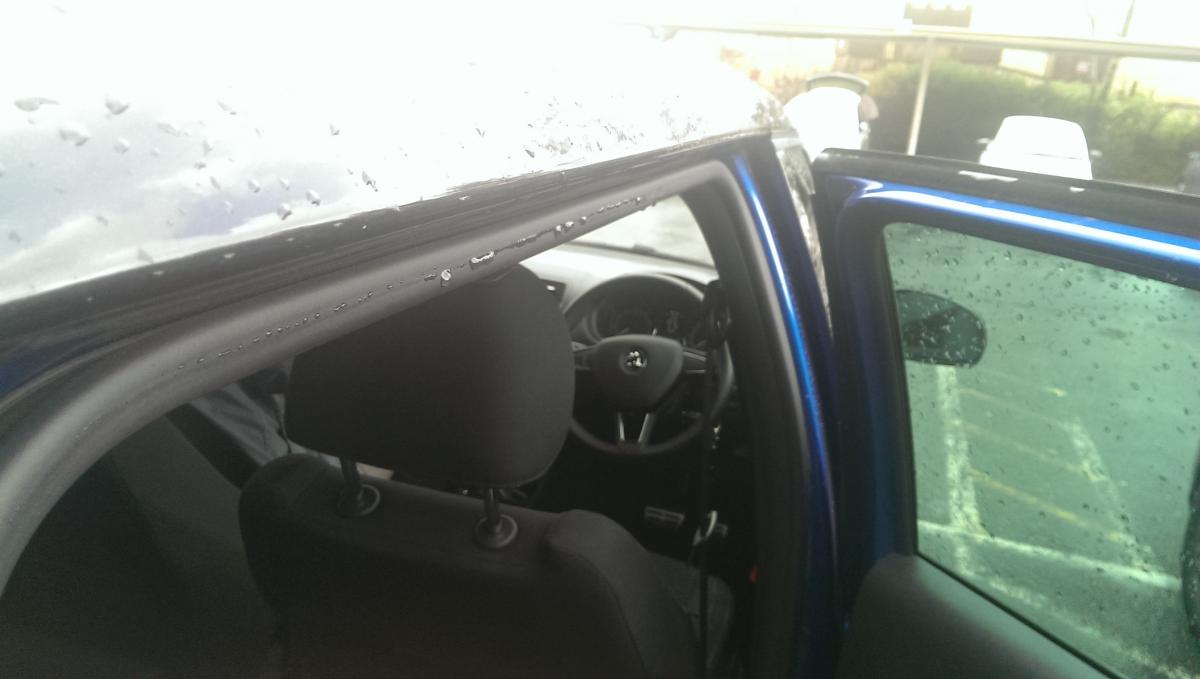

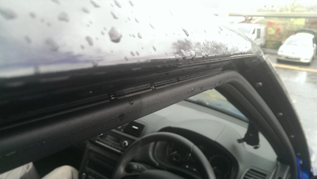

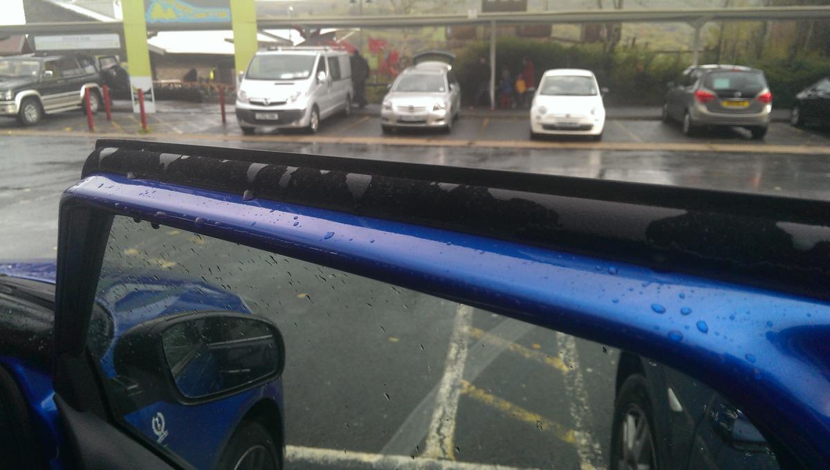

Sat in my car today and noticed my arm getting wet. Seems that the seal between the car and the door was letting the water in...
I know that people have had issues with opening the door and letting the water in but im pretty sure it's not supposed to let water in... Has anyone else had this issue ? Took a couple of pictures to show were I mean.

Do not adjust or touch it if the door gaps are correct & the door closes properly, if it looks right, it most likely is..
Look at the seal that closes along the roof, and see if that is sealing. or it is distorted.
That is where water can come down from.
