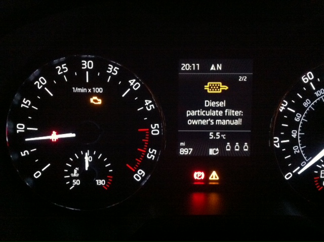

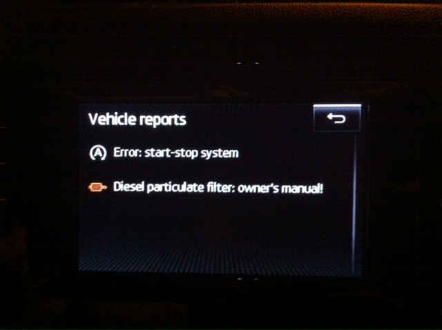

So - here we are again. 500 miles after the DPF was replaced and now still only about 750 miles since new.
First indication that a problem was afoot was the elevated rev's at idle (1000rpm) and very thirsty fuel consumption. I think it was trying a regen then 40 miles later the DPF light came on and back to Square 1.
As I was 120 miles from home, I returned home.  On return home the engine block light illuminated and then also the glow plug light started flashing. So now I have DPF warning and stop/start malfunction and ! on dash.  5 mins later it dropped power and I limped home the remaining 40 miles at about 45mph and max of 3000rpm.
Calling the dealer tomorrow as this is simply not acceptable on a Brand New Octavia Gen 3. Anyone else getting issues like this on their 2.0 tdi?
