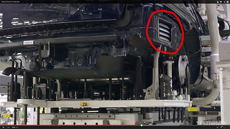

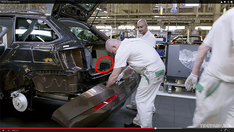

The vents are on the side panels behind the bumper, above the level of the boot floor.

I have tried driving with the tail gate closed but not locked so that air can pass, and then the noise is gone, so I think the problem is the vents that control the cabin pressure.

So either the interior is too well sealed for air to reach the vent, the bumper is too well sealed to let the air out, or one vent isn enough.
Not sure how many cars out there only have one vent. Most have one on each corner

Going on ctx400's post .... I wonder if cutting out a piece of the hatch rubber seal at a suitable place (centre bottom springs to mind) might sort it for those afflicted ?
Thing is that rubber seal is behind the boot wall at the back and if you look there are small round vent holes cut into the wall there (on both sides of the boot actually) to let the air get to it.
Feeling behind the wall through the holes there is like carpet underlay foam type insulation which I wonder if on some cars its actually covering up the vent and not letting the air flow through properly causing the problem? Mine I can just see the top of the foam through the vent holes and can't see the rubber seal but I haven't tried taking the wall off to see properly so.....???
The interior trim in my combi only has holes on the driver side....
Which is the side the vent is
Yes it is drivers side looking at the pictures above.
Have you guys got the insulative material against the metal outer skin in veiw through the holes there? Can you feel it with your fingers?
Because I can't see how interior air gets to the vent if so, which seems to have with a layer of this in the way in mine, and I have the rumbling noise so....
The point I was making was that my combi only has the vent holes on the drivers side while he says his hatch has them on both.....
I've just been out to check, my combi has the holes only on one side too. I've not had more poking around as it was poring rain today so will get a good look on Thursday
