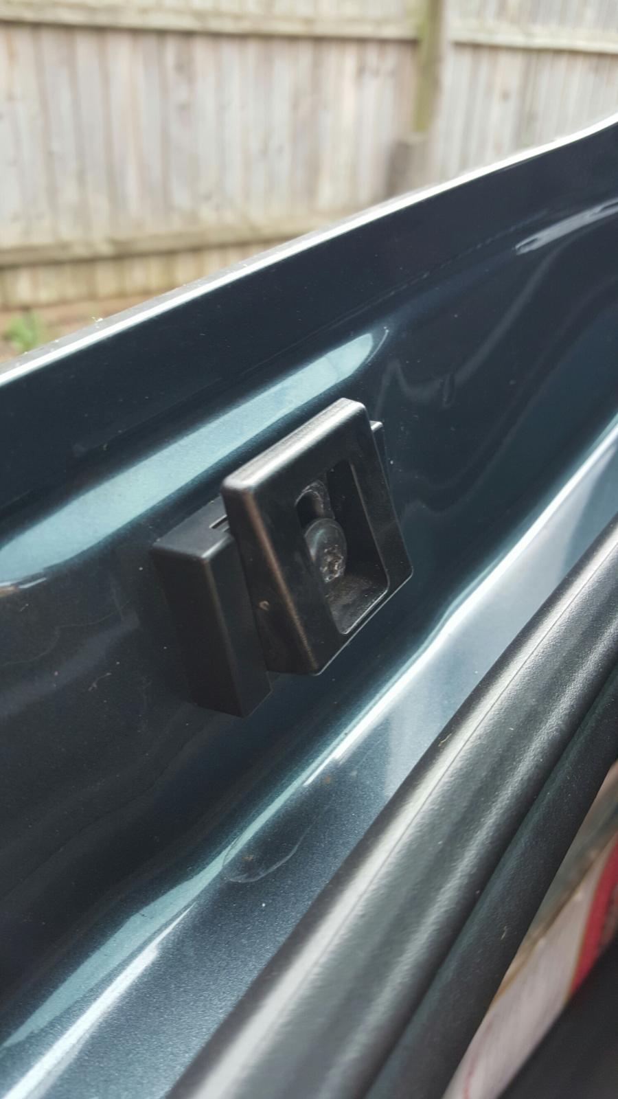

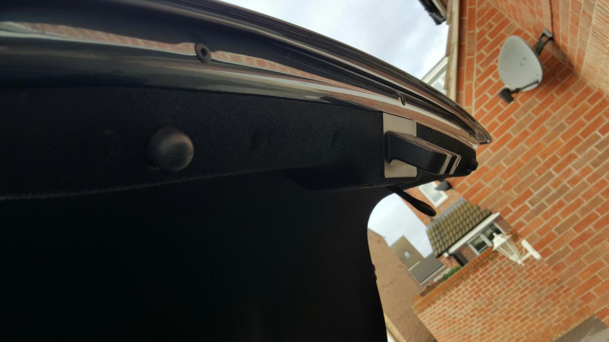

As mentioned towards the beginning of this topic I adjusted the 2 rubber stop on the boot lid by turning them one whole turn anticlockwise:
I then adjusting the two side stays to their highest setting:
That appeared to make a great deal of difference with the booming noise. But for that extra piece of mind I then carried out the following.

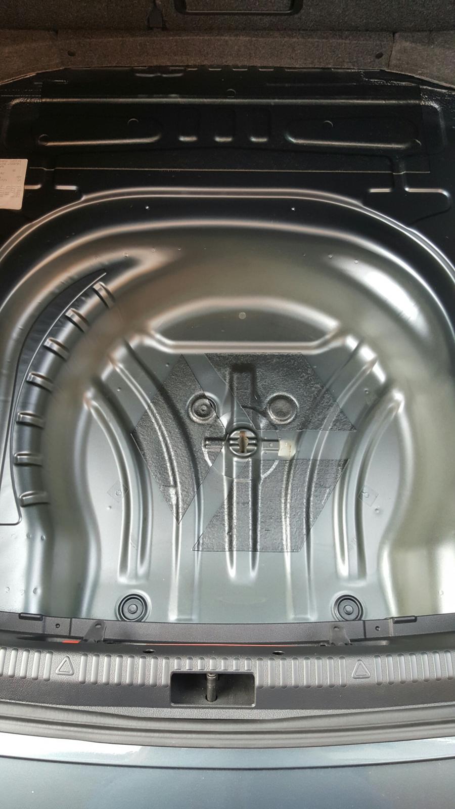

The next step was to empty the boot:

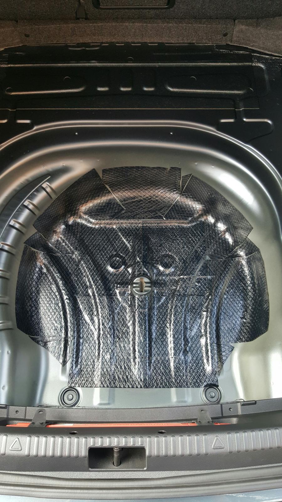

Then it was time to line the boot with the soundproofing. After working out the best way to lay it, I cut the required sheets to size, heated the backs with a hair dryer then stuck them in place:
I also added a small strip along the bottom edge of the picture after trial fitting the space saver spare wheel, I didn't get a picture with it fitted unfortunately.

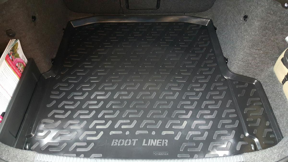

I then purchased one of these:
The result, for me at least, is that I have cured 95% of the noise that I was experiencing.
