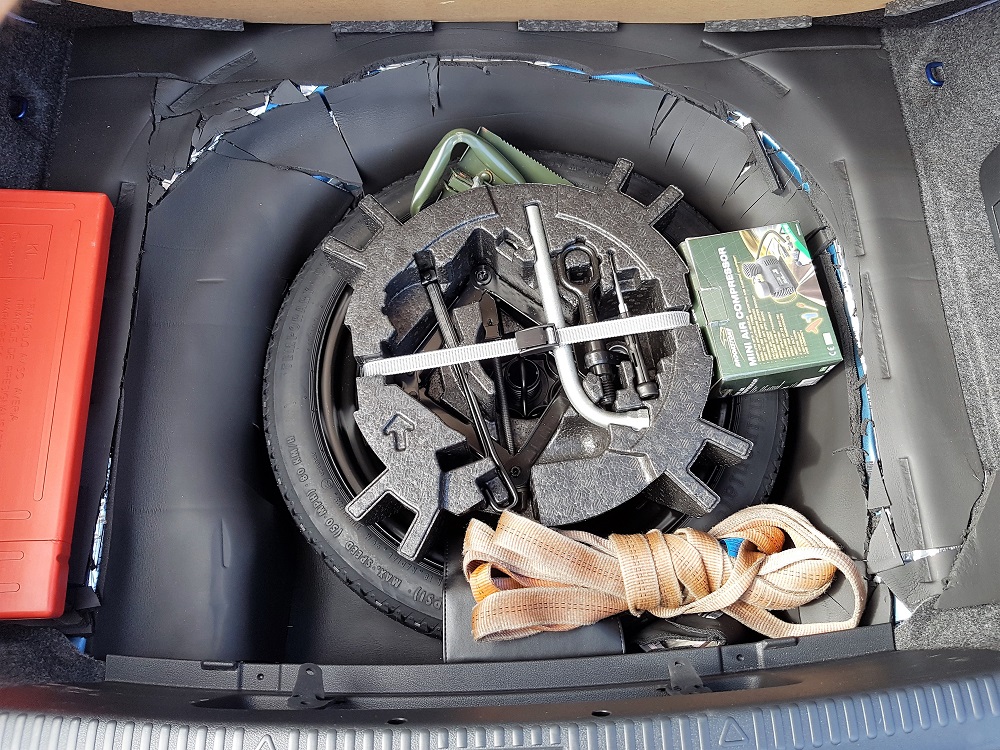

I gave my boot floor the SilentCoat treatment similar to the link above and it has made a good difference. I was getting a nauseous/headache feeling when driving my car for more than a few minutes at a time but haven't noticed it since fitting that stuff.
I didn't cover the entire boot floor, probably only 2/3 of the surface area so it doesn't look as neat but then again it's under the carpet so not noticeable. It's relatively cheap and very little effort so worth a try.

I have bought some silent coat and am waiting for a nice day, one thing I have just thought of regarding it's instalation is this. The idea of this stuff is to attenuate vibration in two ways, 1 changing the resonant point of the material you have stuck it to, 2 attenuating the vibration amplitude.
This is my question, what difference is it going to make for those who have a spare wheel, I suspect a little. But I think th he biggest difference is buy a spare wheel for those who don't have one. I am going to put some under the rear seets and boot walls.
