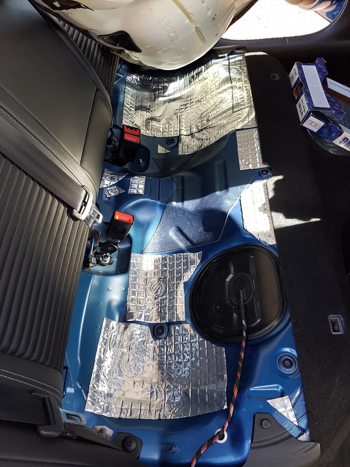

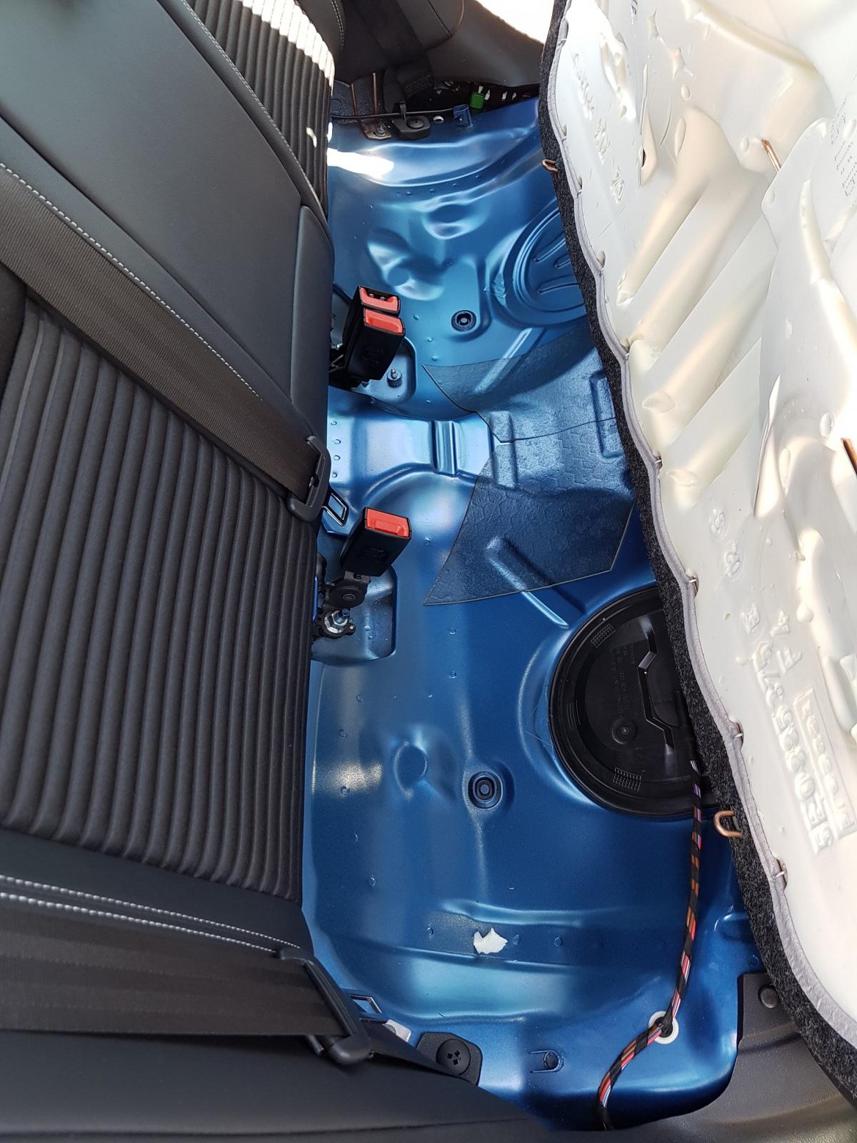

I did under the rear seats this afternoon and took a couple of photos
Before:

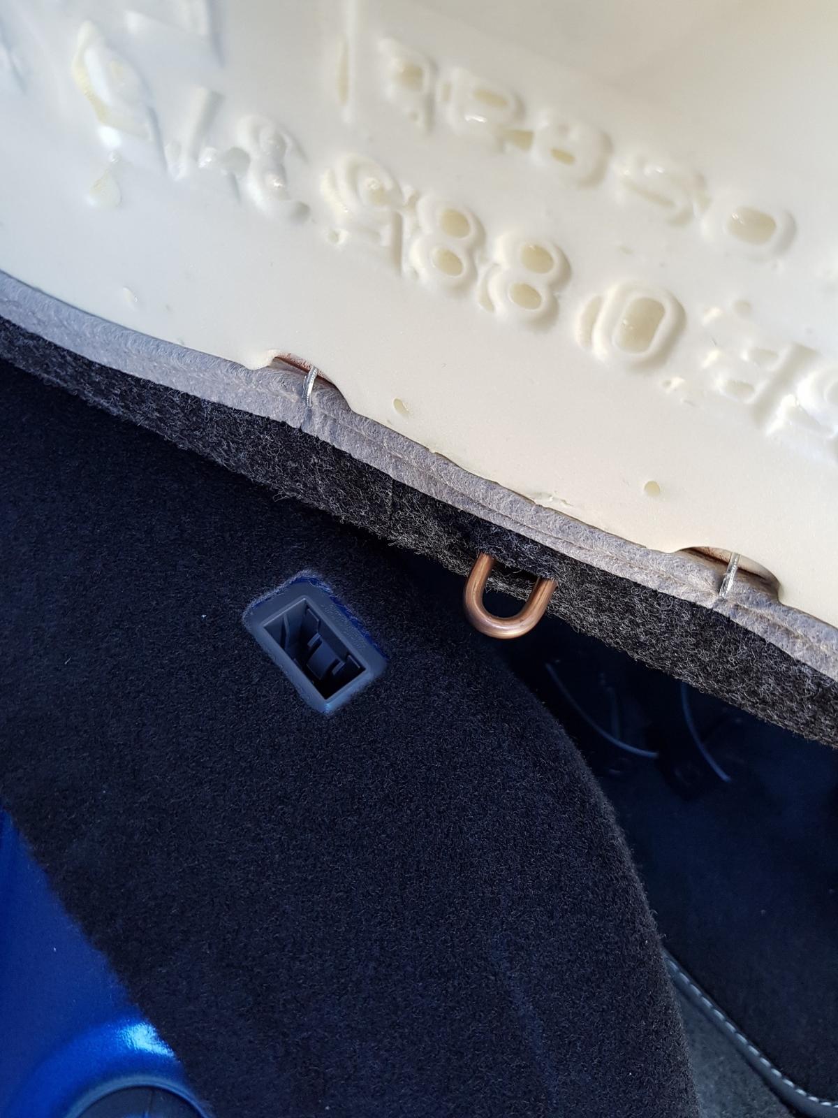

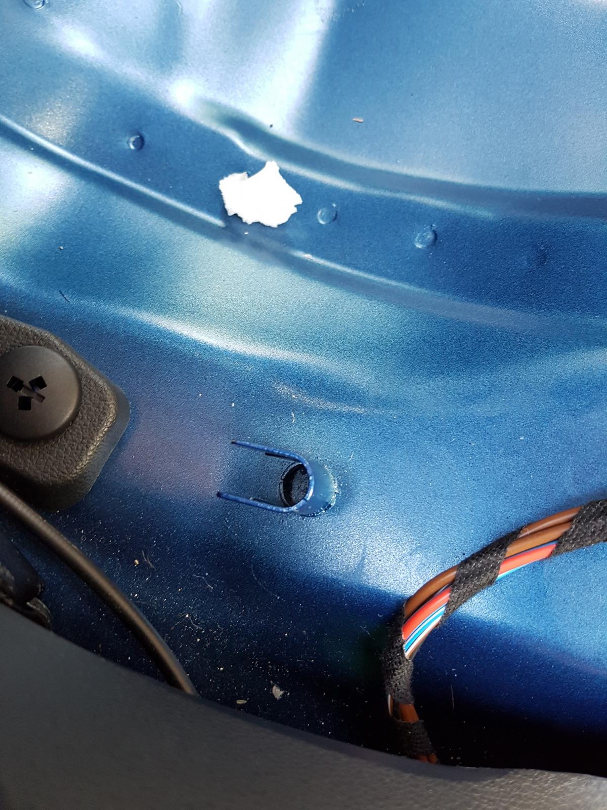

Clips at the front of the seat base:

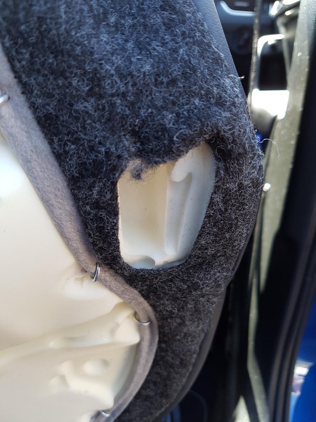

This bit gets stuck on that bit. You wrench it upwards but I managed to unhook it:
After:

Someone else has posted how to do it but here's a recap:
1) Remove the plastic covers from the isofix fixings x4 - they lift and pull out
2) Remove the plastic surrounds from the isofix fixings x4 - these take a bit of wiggling but come out quickly enough
3) There are two clips which hold the seat base in place. These are one on each side, near the front. An upwards tug will undo these.
4) There are two metal lugs which were caught on the foam. One at either side towards the back. You could just pull it up at the point and risk tearing the foam but I managed to squeeze the base backwards and over the metal on one side at a time.
5) Lift it out
Apparently you're supposed to replace the plastic retaining clips after removing the seat base but mine seem fine. I have been waiting for the warmer weather before doing these tasks so that the plastic clips are less likely to snap.

Have a look at my post #897 I've done the entire surface under the boot floor lid thingumy. About 66% coverage with the silentcoat and close to 100% with the foam. Once you've gotten rid of the boom you'll be onto road noise from the tyres. One day, if I'm feeling adventurous, I might investigate the trim around the wheel arches to see if anything can be done there, as well as doing to doors to help improve sound quality from the Canton system.
