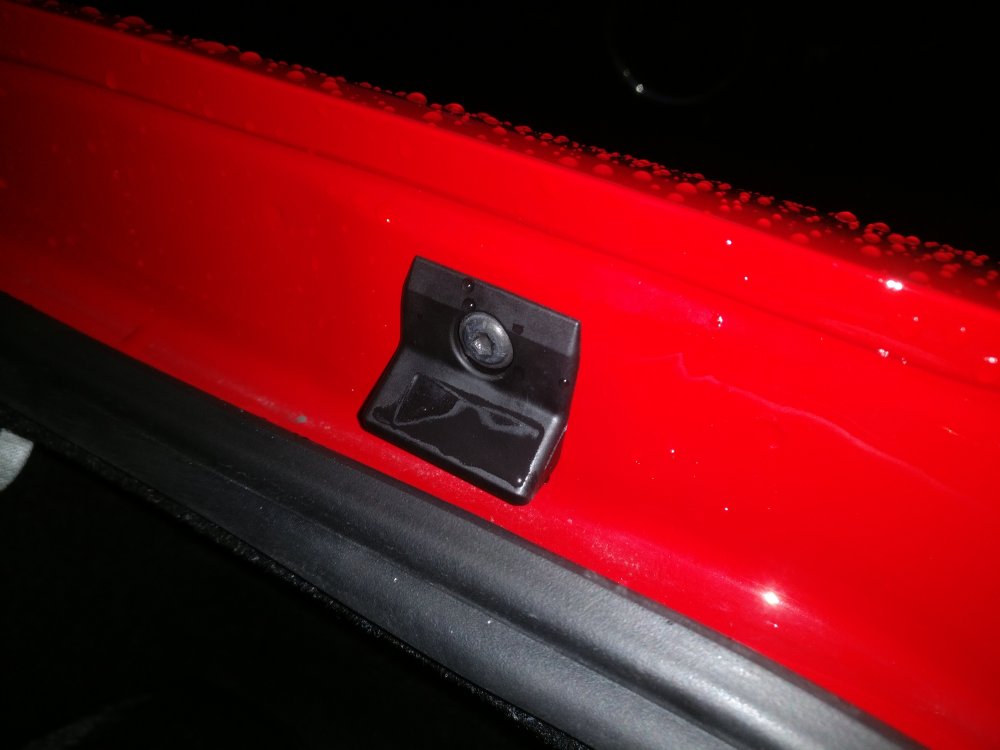

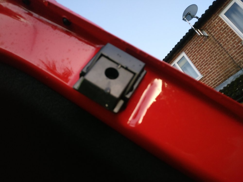

I have been doing some research and it appears that Skoda have changed the design of the side boot buffers / catches.
The revised parts look more substantial!!
Waiting to to find out part numbers.
Thanks to new member Uktotty for the photos.
My my car is the quartz grey and uktotty is the red - both vRs hatchbacks. Mine is 2015 and there’s is 67. EC9D8CEC-D084-404C-901C-BE8D4B63688E.thumb.jpeg.49bf844a6538390f841cb3decf98a63c.jpeg2BD347EE-FE8E-4D04-B9D6-3B9C254DBC2C.thumb.jpeg.39b53465b08617b6063c4264c75e69e4.jpeg
Be intrested in some of those too,  if they work.
See my previous posting above!
I have adjusted the boot latch so tighter and adjusted rubber knobs on base of boot
I have got hold of the buffers that are being fitted to the facelift model.
I always noticed the rear boot seemed to be poorly supported and heavy.
They are a straight swap over - more substantial support on the sides.
My booming has gone!
Which makes me think Skoda changed the part for the facelift model due to complaints - a conspiracy maybe?
Around £14 for parts.
Also found reference in a TPI
if complaint about pressure (blocked ears type feeling ) Skoda dealer should send technical query about door closures
I can get parts number from packaging tomorrow if anyone wishing to try this mod and see if it works for you??
hope this helps
