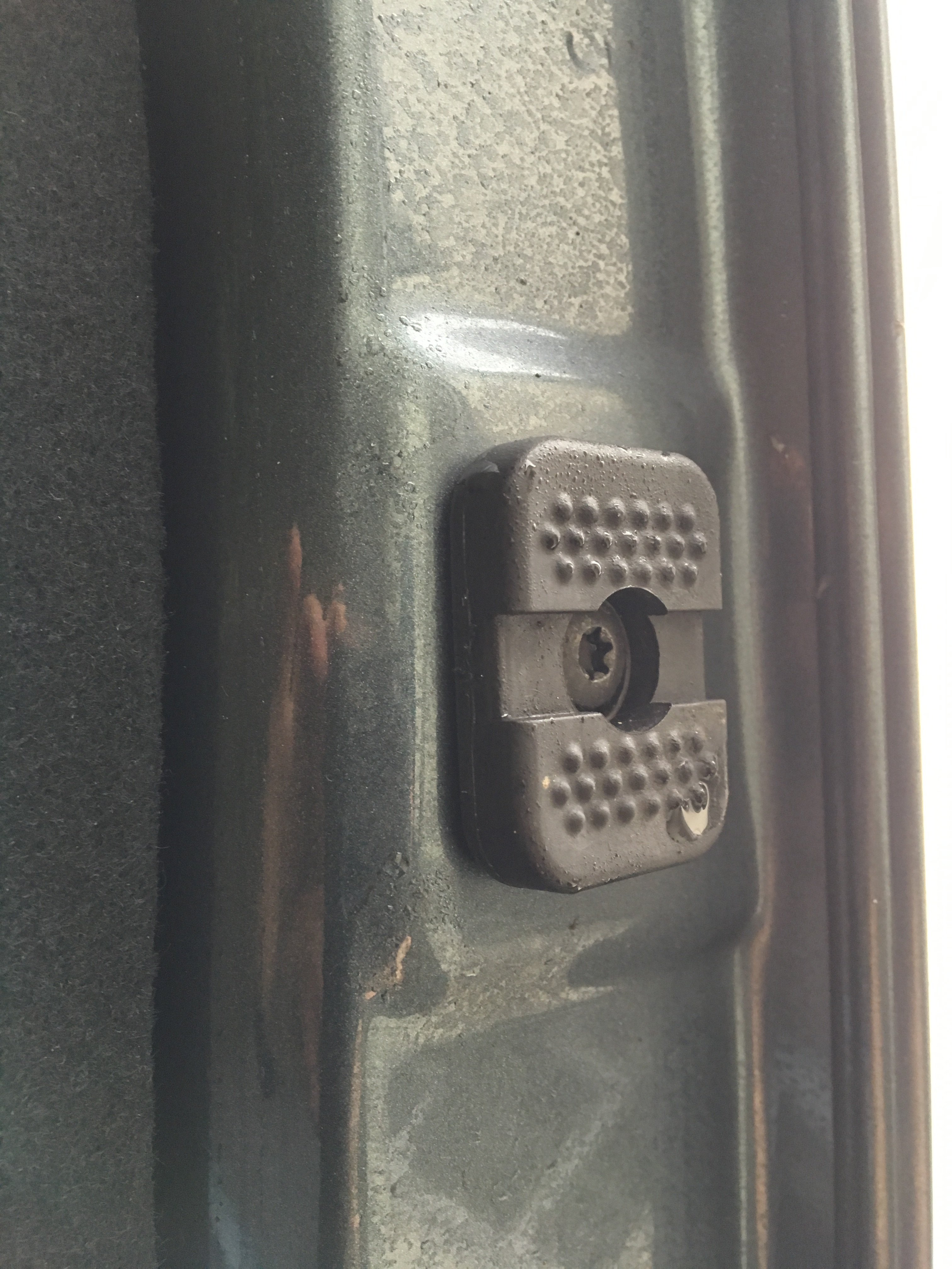

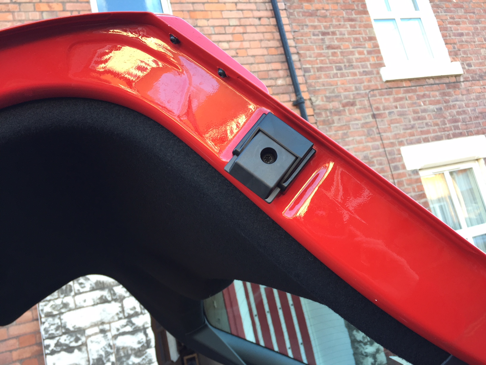

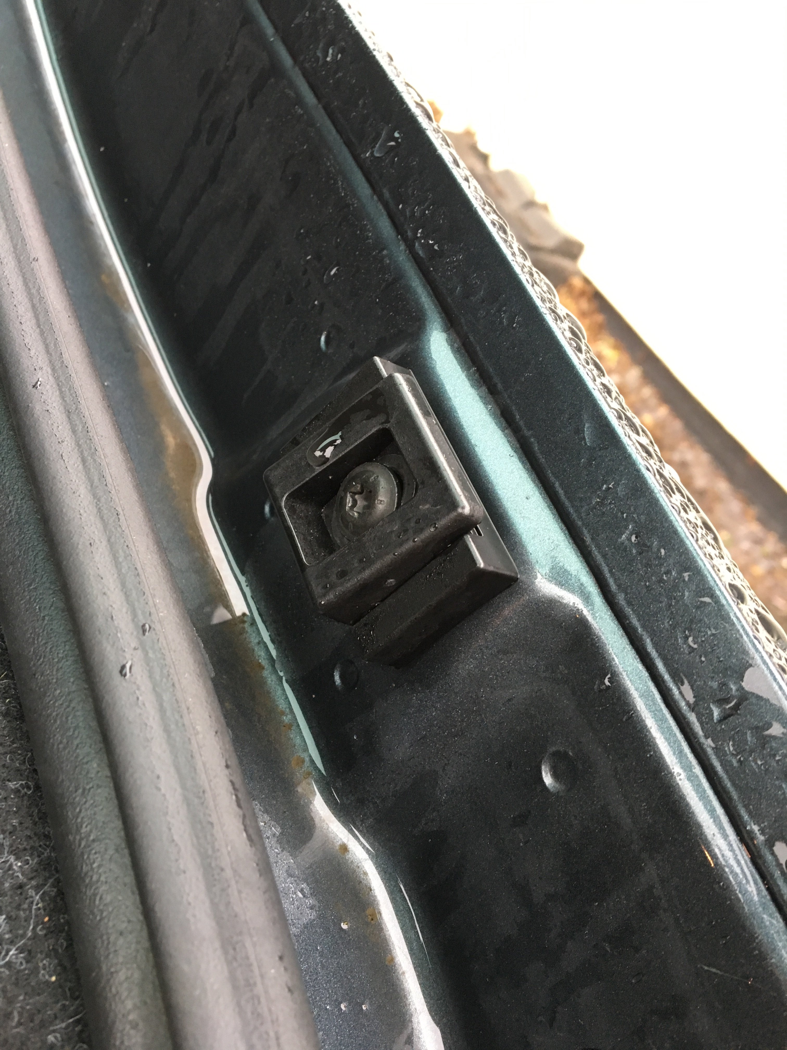

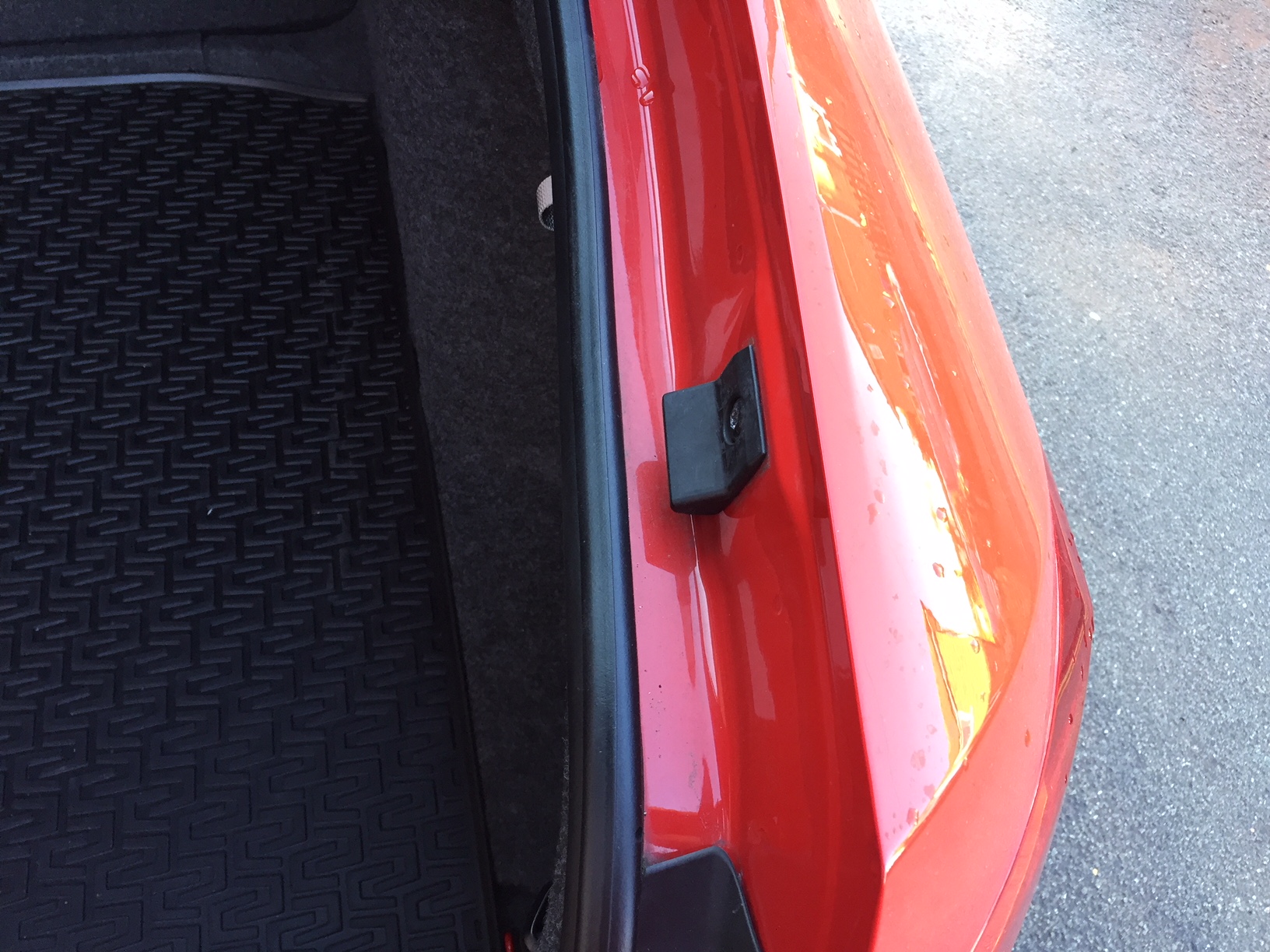

Here are the pictures from my Superb hatch - what do you think?  I think they're pretty close apart from one of your pictures on the red Octy which looks different.  I'm hoping you'll say there are clear difference and will put me out of this booming misery.
Yes they look the the same as the hatchback Octavia I took off.
The red red car is th latest facelift Octavia with the different buffers which are spring loaded.
