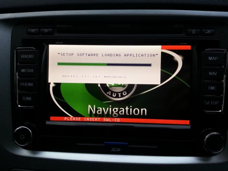

Success - I have just updated to firmware 5270 and software (maps) 8048 (and have photos to prove it).
Before
Delivery part number 3T0035680E
HW-Version                 H61
SW-Version                 5270
Active map coverage  West Europe
Active map supplier    Navteq
Map version HDD:      7918
After
Delivery part number  3T0035680K
HW-Version                H61
SW-Version                5270
Map version DVD      8048
It all went smoothly (a couple of scary long pauses during firmware upgrade) and after just the firmware upgrade I still had the v9.0 maps, POI's and music on HDD as before since this was an 'upgrade' firmware image and not a 'factory' image that removes everything.
I then upgraded from v9.0 maps to v10.0 which is much easier as you can run the car, listen to radio/music while the DVD rattles away for almost an hour.
I now have the 'Testmode' extended secret menu and 'Radio text' which is useful. I should have 'Video In Motion' too but haven't tested it yet.
So I have a new operating system and new maps to start the new year - Happy New Year to all our readers too!
