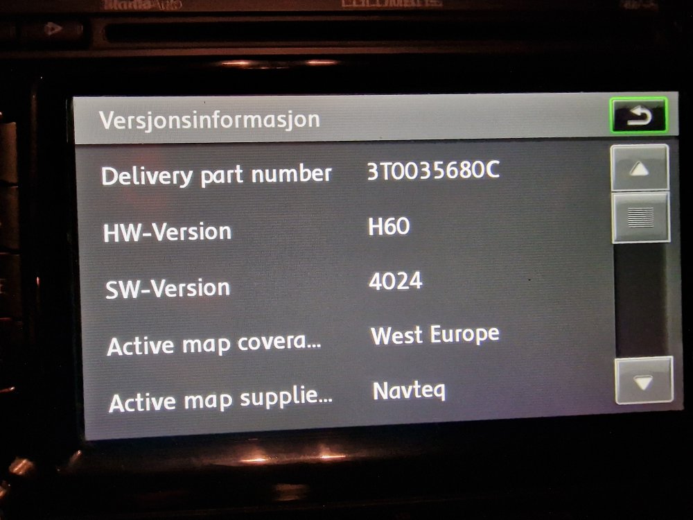

My current firmware is showing as 1304
Have tried downloading what appears to be 3810A firmware, but keeping getting an error message when trying to load it (010306 I think) - the unit is recognising it as a SWL disc, but then throws up the error
Believe I need this before upgrading to 4020 or 4120?

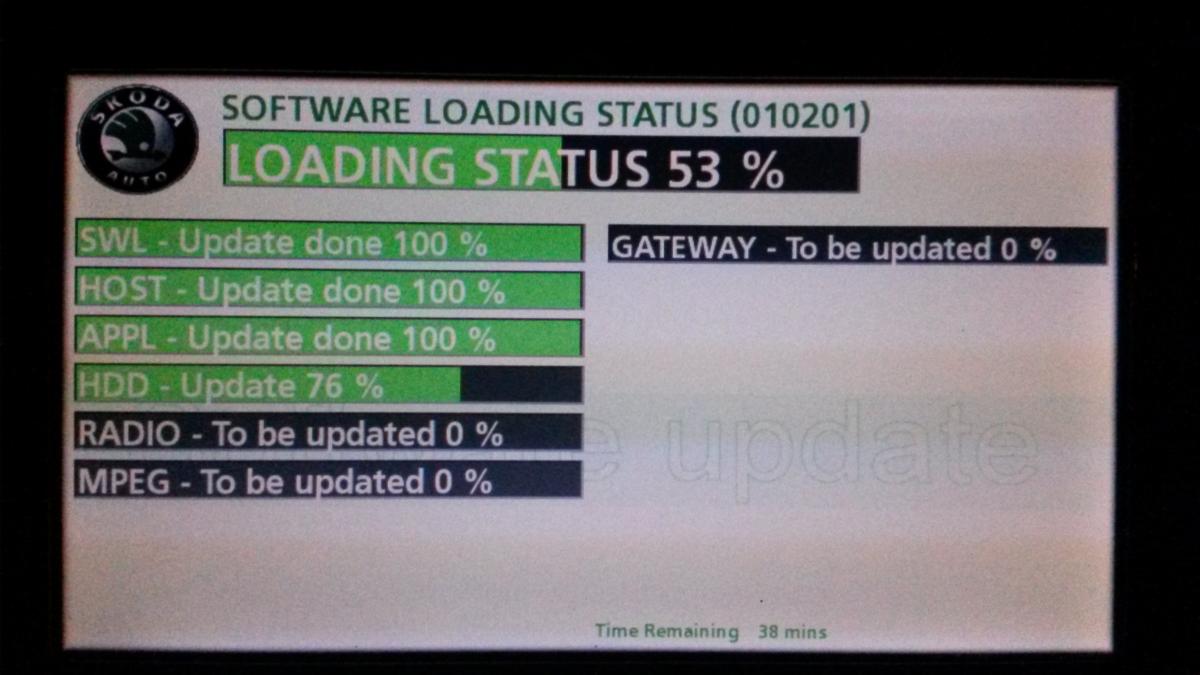

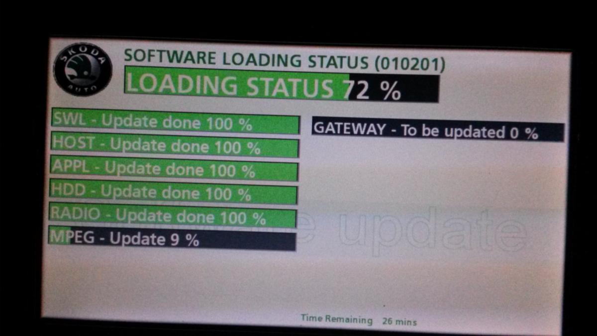

4020a loading well
Did it finish ok?
Did it finish ok?
It did, it's fully loaded, just need to check that there are no issues with maxi dot, then load maps
