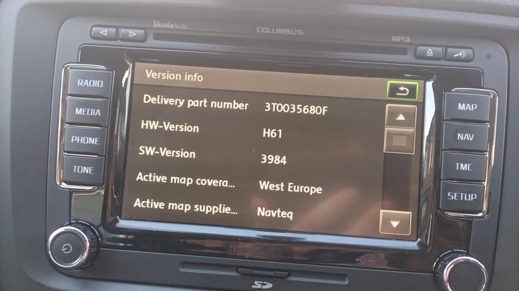

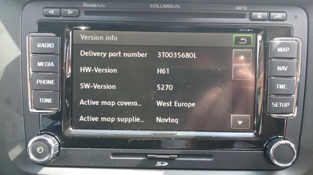

skodapeter - as I wrote in my update #10 above I went from 3984 to 5270. As I wasn't sure if 5270 would work I also had several intermediate levels available to try. Anyway, I now have the 'Testmode' extended secret menu and 'Radio text' which is useful. I also have 'Video In Motion' too but wouldn't use it. There is no noticeable difference in performance.

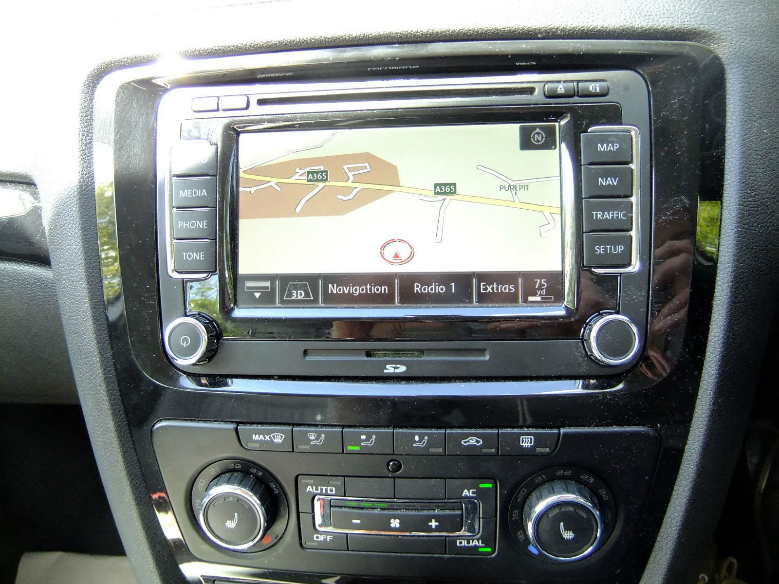

I have a FL 2009 Octavia with the Columbus system. Are you able to update the maps for me? Also, is there an update to put in full post codes?
I am based locally ish in Bristol.
My Columbus system has a button called 'Traffic' instead of the pictured 'TMC'
Many thanks, Andy
Edited by abys
Update to firmware I can certainly help with. I'll PM you.
