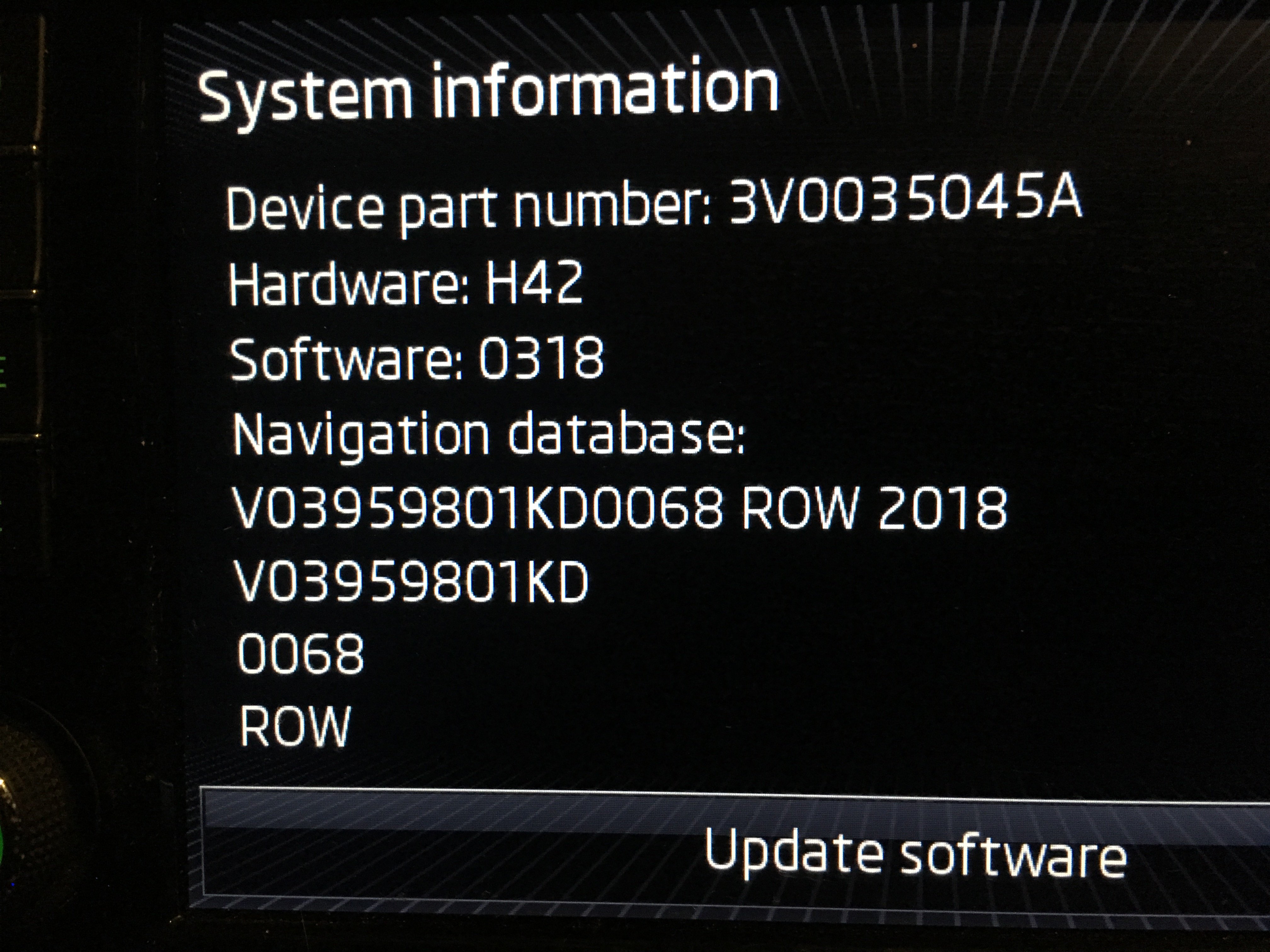

I have a 2015 Octavia with columbus/canton system including carplay.  a couple of months ago I started the car as usual, plugged in the iphomne and the radio/system did not work. Eventually turned off the car and started again,  Everything now works except the USB port and of course carplay cannot now find the phone.  and the phone will not charge from the USB port.  The system cannot see any USB device.  Plugging in a USB stick it flashes 3 or 4 times then nothing.
My system info looks different to others posted here - a later model?  :
 What to do?
The Skoda infotainment web site says there is no software update for my car.  But do I need to re-install the software to fix this?  If so where do I get the image?
BTW I am in australia
Cheers Trevor
sorry for previous post.  I now relalise that I have a MIB system so this is not the appropriate thread...  It can be quite difficult to figure out RNS numbers, MIB1, MIB2 etc and what they all mean..
cheers
Trevor
