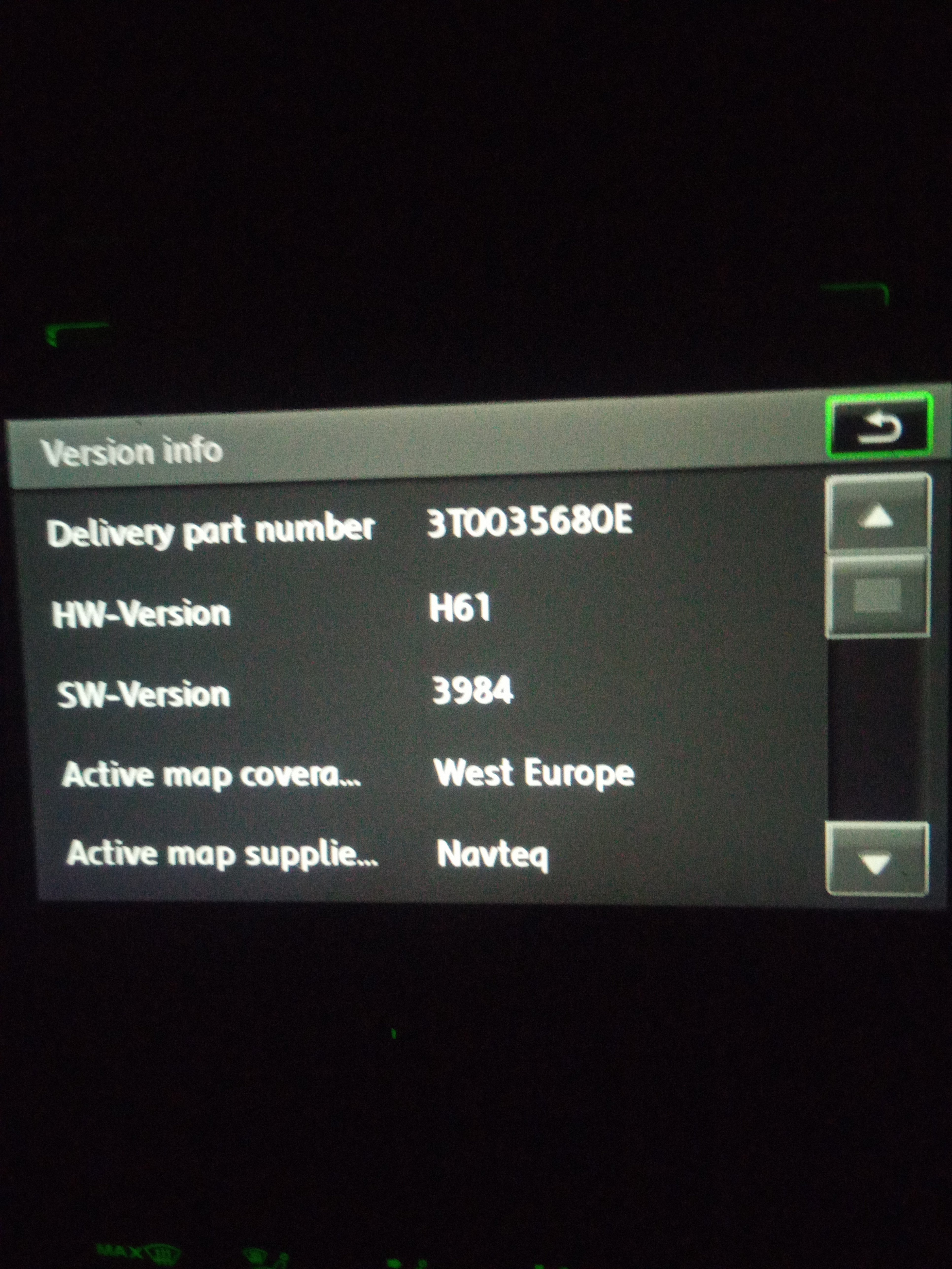

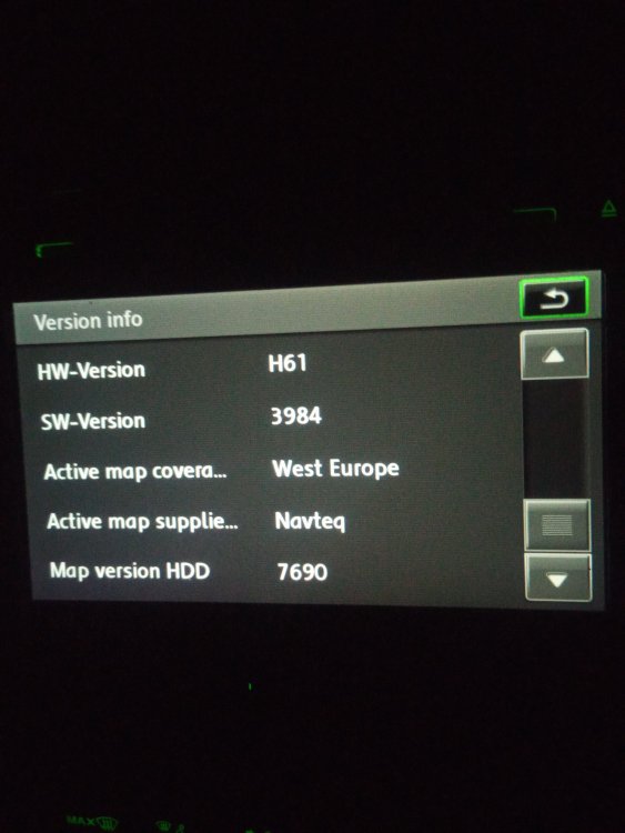

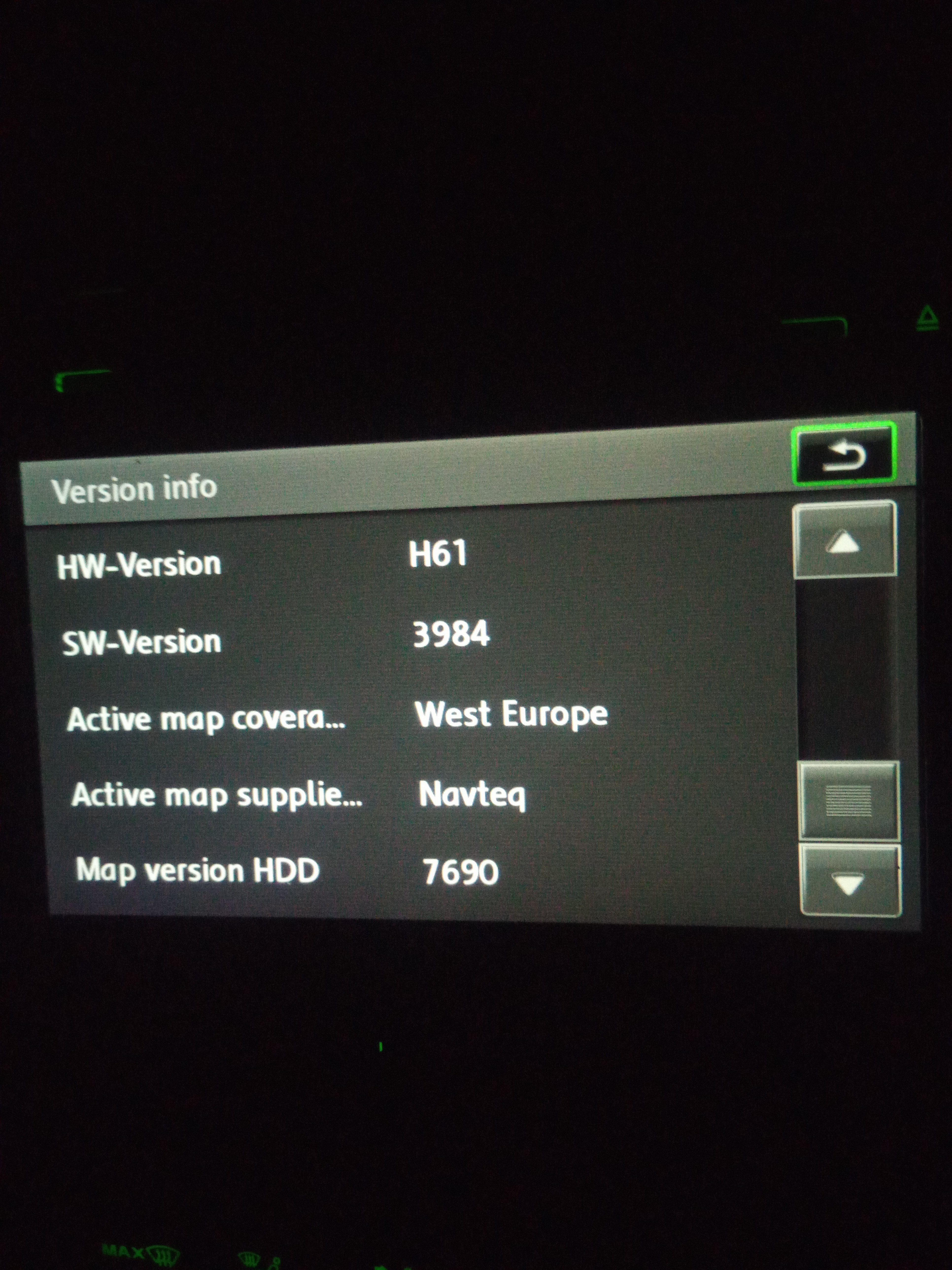

Looks like I'll need to arrange the flashing with you then; could you forward details?
Reason I'm thinking of updating software is because I've read somewhere that the current map version requires the hdu to be reconfigured to 3 partitions to fit the maps in with the POIs.  TBH I dont use the unit for music; I just cart a few sd cads about with it on
Your unit already has three partitions. Nothing needs to be done.
That sounds like a lot of worry done away with.
I have a bit of a rule of thumb with "upgrades" - if it doesn't need doing, don't do it! Had to sort out too many failed upgrades and updates in previous work.
I'll get on with sourcing the latest maps then and see how it goes.
Thanks

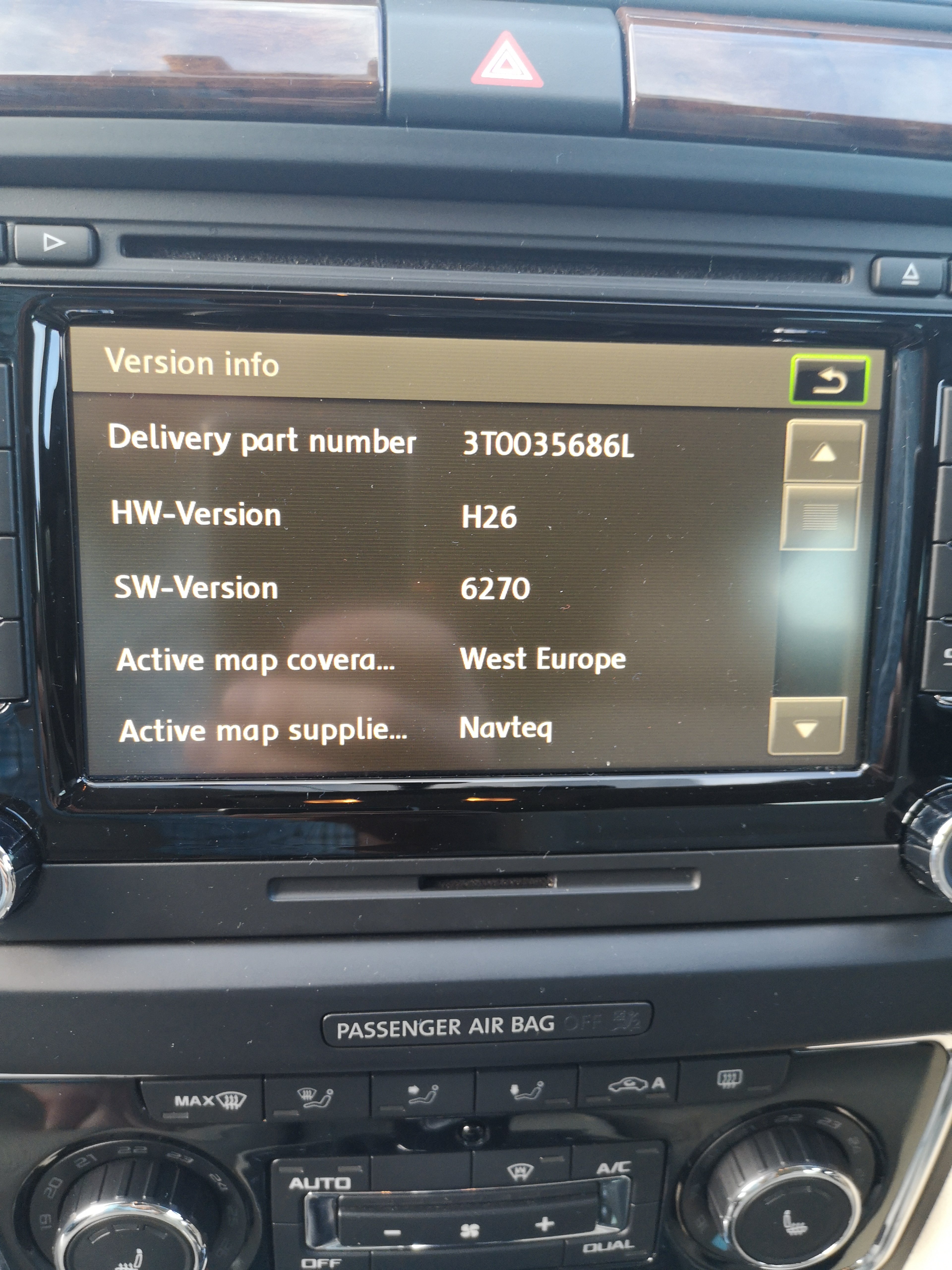

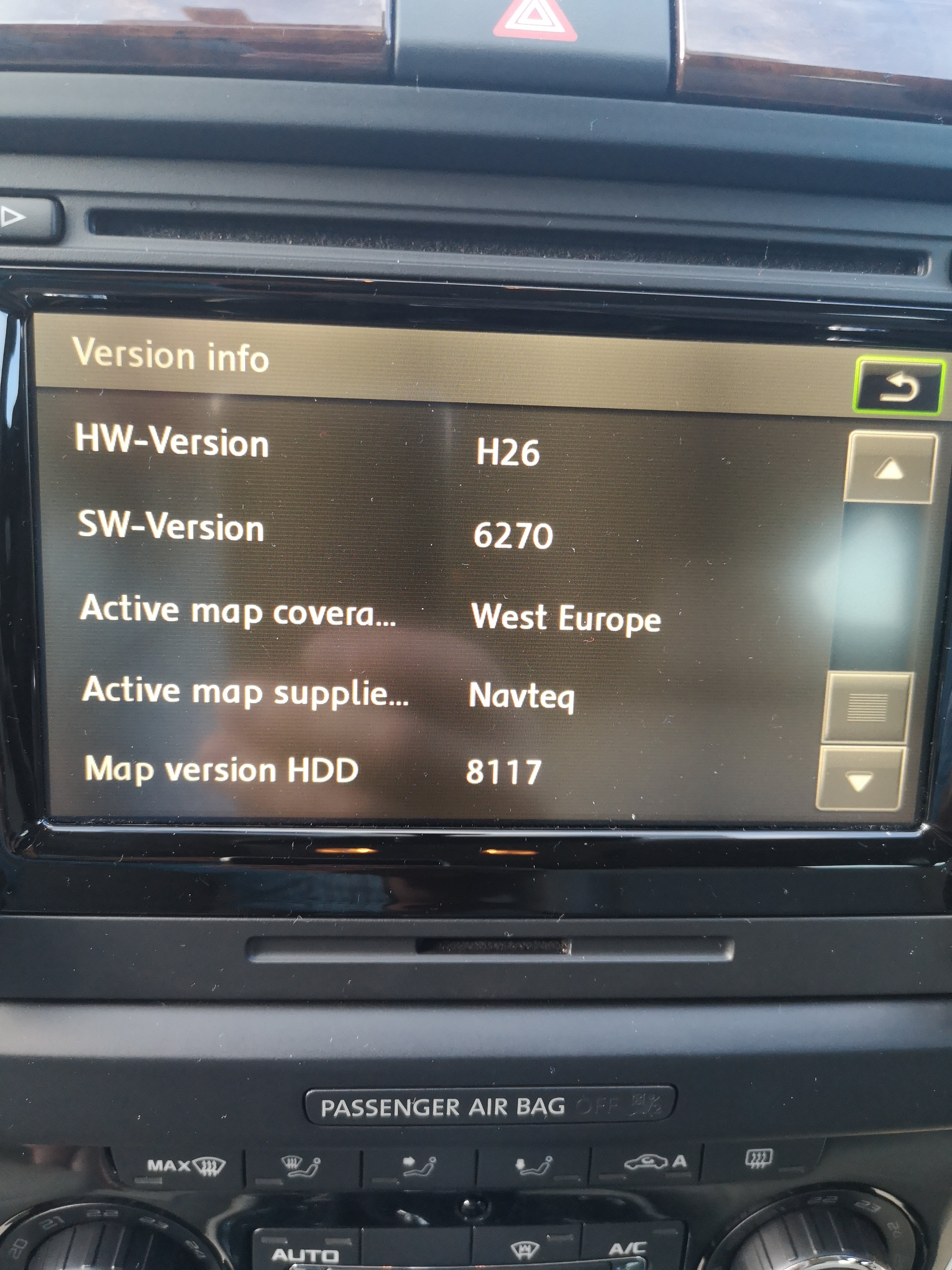

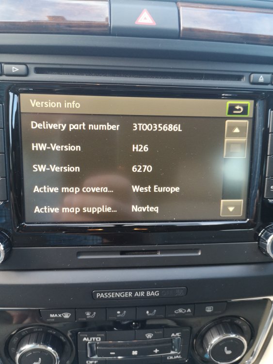

There's no benefit in updating the software if that's what you're trying to do. Maps could be updated though as you're a couple of years behind.
OH...thanks 😜
So far I know that I need to have proper dvd and sd card for maps update. Any chance tha someone can give me directions which version of map or file I need to find ?
You need a DVD for the maps. They're too big for a single DVD so you need a DL DVD. V16 maps which are 8536.
