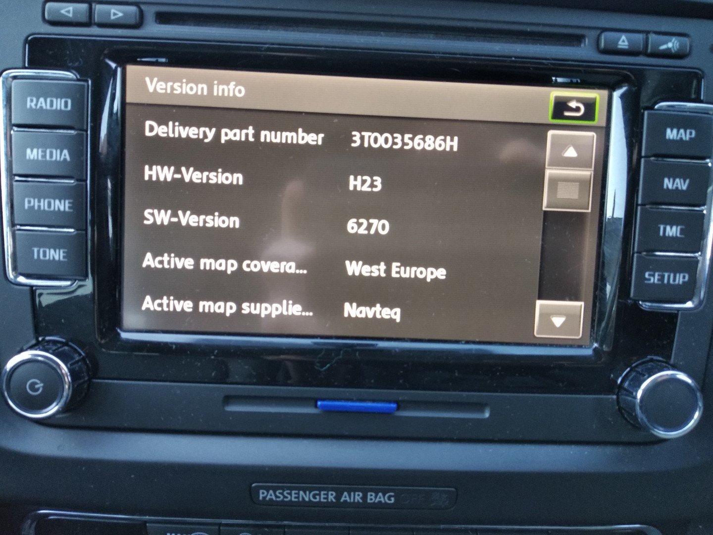

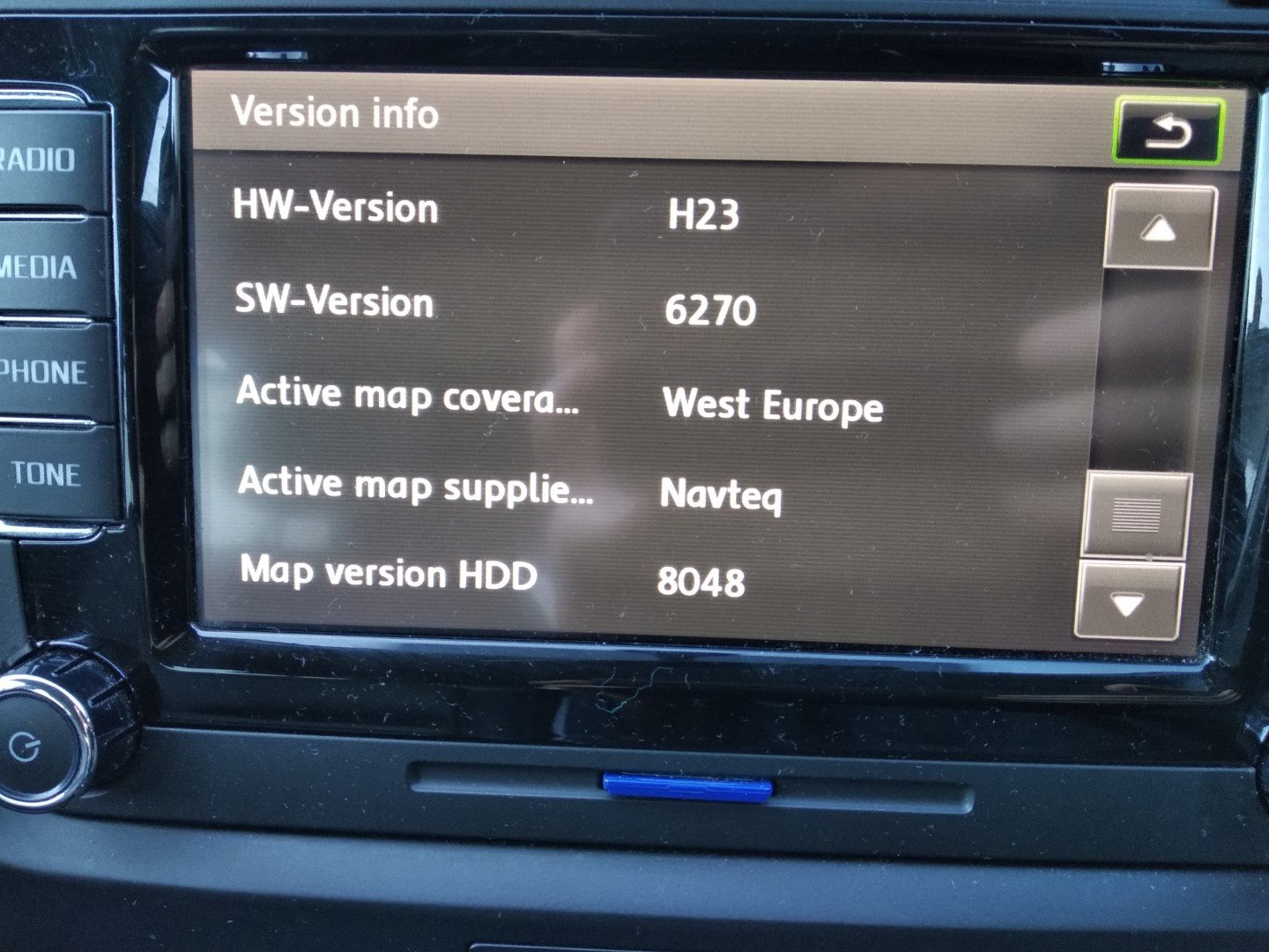

My unit has:
HW: H23,
SW: 6270
Map 8048
If I eventually mange to find a download site for the maps will it downgrade my software to 5238 and what effect will this have?
Many thanks
Andy
Edited by Discusb
Added photos
None of the official VW/Skoda maps include a speed camera database so I doubt any other map downloads do.
No maps update will change the software level of your unit. You have 6270 software and that's where it's going to stay, unless you decide to upgrade the unit to 6276.

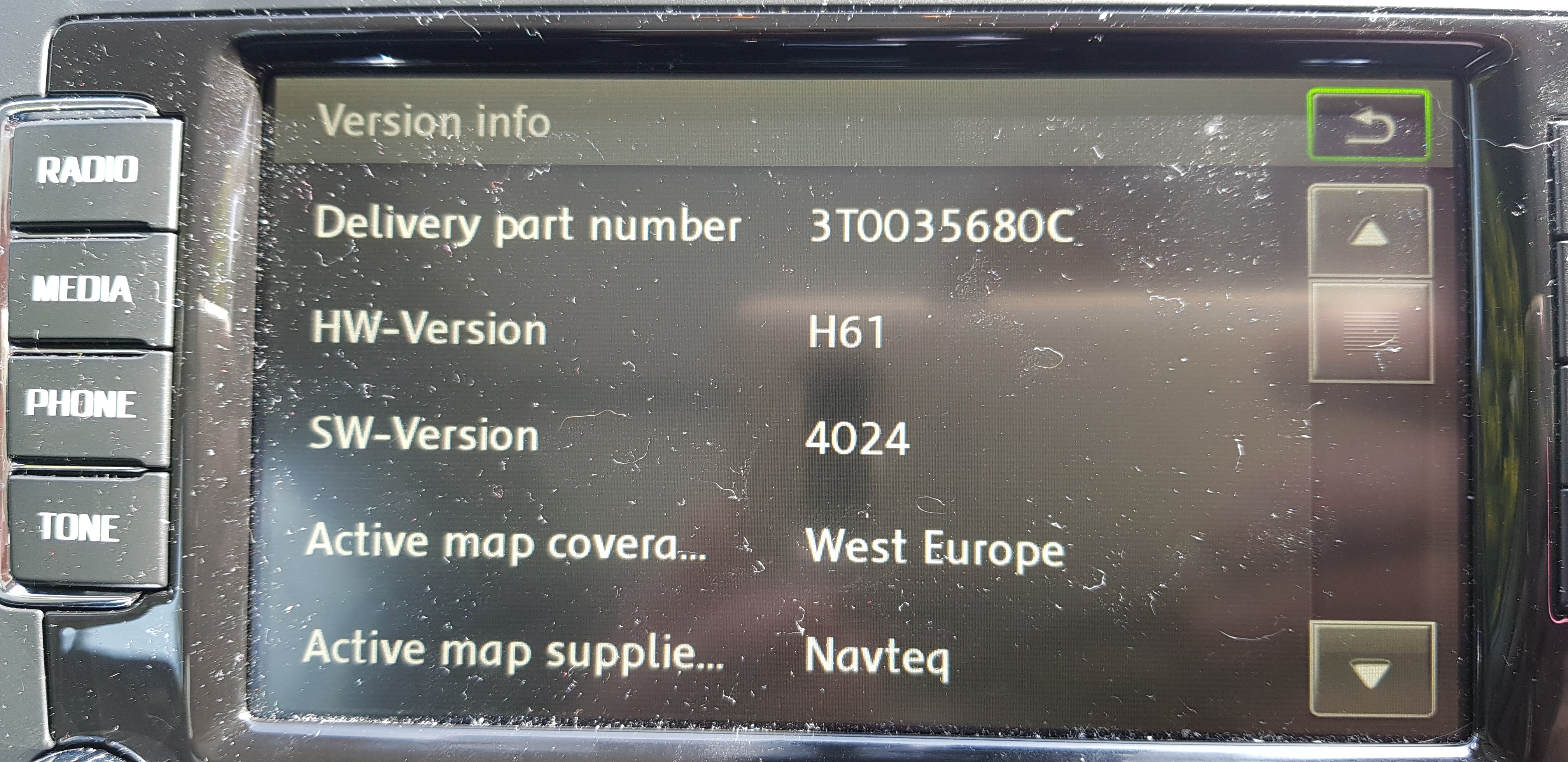

Good Morning.
I'm a bit new around here, so please excuse me if I ask questions that have already been answered.  Trust me I have searched, but come up with no answers.
My 2012 Superb badly needs its maps updating.  However, I have a couple of problems I think I need to resolve before I try this.
Firstly, I cannot delete old destinations, nor will the unit remember any new ones for more than a few minutes before reverting to the old list.  It does clear the list when I perform a reset, and appears to store the new destination I program in, but then, after a few minutes, dumps the new destinations and comes back with the old ones.
Secondly, occassionally on a restart the GPS appears to "lose its way", often showing a position some distance from where I actually am.
I have attached an image of my Columbus part no, hardware and software details.
You need a flash wipe performing on the unit, and it sounds like you might need a new GPS antenna. Antenna a few quid off eBay and the flash memory needs to be performed here on the desk or by someone with the correct hardware and software.
