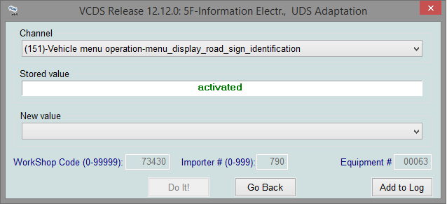

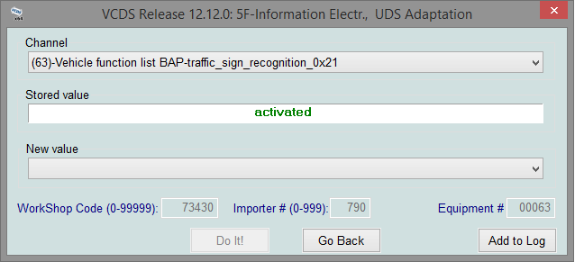

Controller 5F (Information Electrical)
10 - Adaptations
Select channel: (63) vehicle function list BAP traffic_sign_recognition_0x21
Adjust Value to activated
Channel: (151) vehicle menu select-service menu_display_road_sign_identification

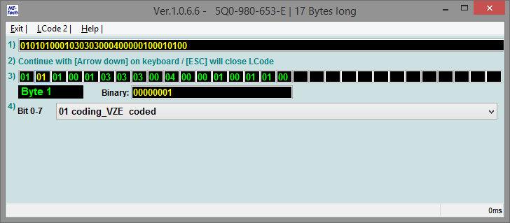

Controller A5 (Front / front view camera)
07 - Coding
Byte 1
Bit 0 Enable - "01 traffic sign recognition (FTE) active"

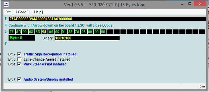

Controller 17 (Instruments)
07 Coding
Byte 5
Bit 2 Enable - "Traffic Sign Recognition installed"

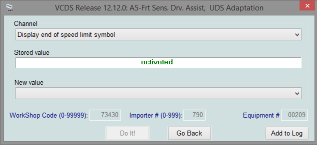

16 - Security Access - enter 20103
10 - Adaptations
Select channel Display end of speed limit symbol
Change to activated

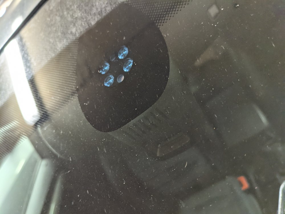

You need Lane Assist, Colour Maxidot & Columbus.
Don't think anyone has tried an Amundsen with it.
Ah, you need to have lane assist already. I see. Oh well, just means i have to look at the road now :think:

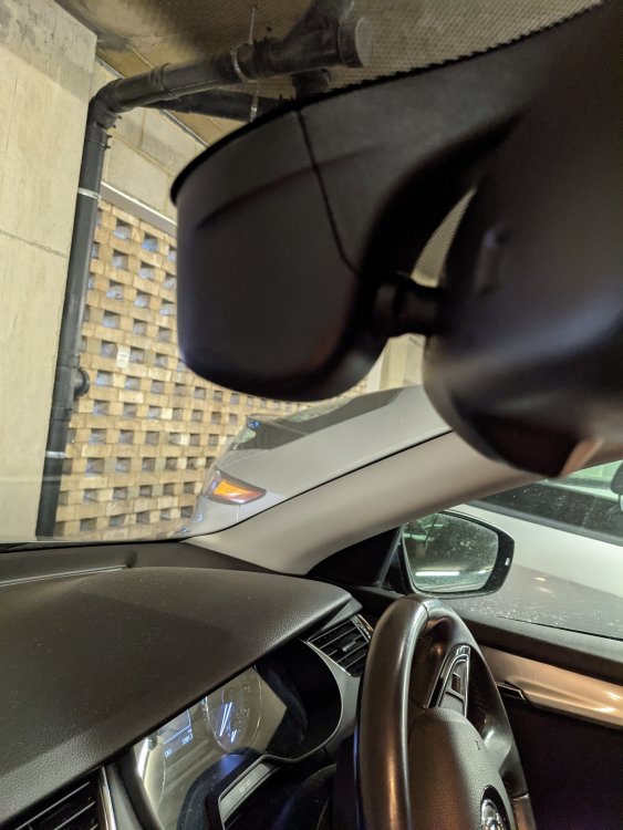

Yep, it uses the Lane Assist camera

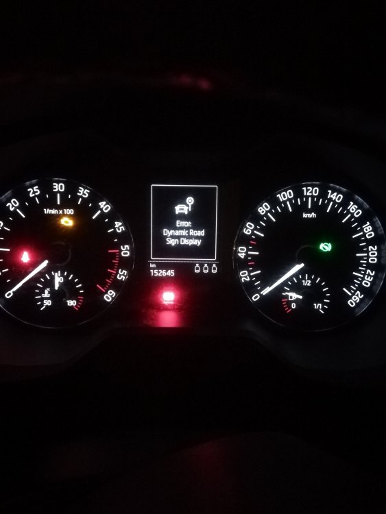

Here's Traffic Sign Recognition working on my vRS with Bolero and standard B&W Maxidot:
There's also another page on the Maxidot if you want it 'full-screen':
