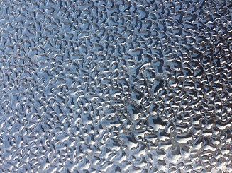

post-122362-0-82744100-1444731292_thumb.jpg   My wife's brand new Leon FR. Factory fresh, no products applied yet.

attachicon.gifseat leon beading4.jpg   My wife's brand new Leon FR. Factory fresh, no products applied yet.
Ohhh - nasty; I'm sure a good decon detail and LSP would bring that up nicely.
What are your plans for the Leon? Products etc?
Easily rectified
What do you plan to do?
I was thinking of Nattys paste wax. Unsure about applying poorboys blackhole before hand. What do you guys reckon ? I don't want to damage the paintwork as its absolutely flawless with it being brand new :sweat:
TBH you don't really need the Blackhole
I would just use the Nattys on a new car
More value in applying a good sealant before the wax - rather than Blackhole. :thumbup:

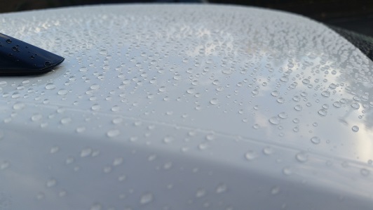

Not the best of pics but some fusso beading. I'll get some more when it rains.
Interesting the chemical properties in it. Doesn't like my vinyl stripes or chrome strips.

What's your LSP?
It was the Fusso.
Apparently I've been told on detailing page on Facebook that I should of stripped my wax first as the Fusso has reacted with that. Probably. an element of truth in that as the Dodo juice is probably,on the car 4/5 weeks and was still protecting ok.
I'll polish up the chrome and stripes and then reapply the Fusso. Interested to know the longevity of this but I suspect I'll need to strip all the wax off the car first and then reapply.
It does repel the water great.
That is a possibility
There are several products designed to detox/strip paintwork
I use AB Waxoff and G3 Dewaxer....Carpro Eraser and diluted IPA + a Farecla Clay Mitt and/or BH Soft and Medium Clay
What have you got for this?
It was the Fusso.
Fusso water behaviour is exceptionally good.
I have always used it as the base sealant - and never applied on top of wax;
so the info from the FB detailing group good be correct.
Sealants should never be applied over wax ...there are exceptions...BSD and other QD Sealants for example
A strip back is your way forward
Ok thanks both. Maybe for now I'll leave it. I haven't got anything to strip back. They be other less treated cars to test on :D
