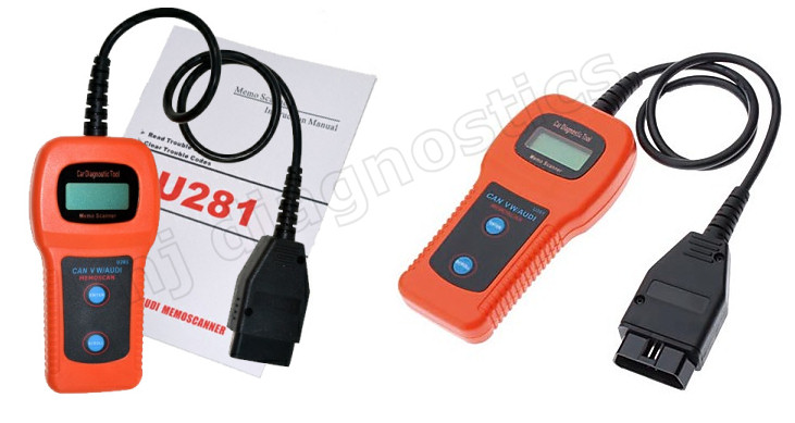

I ordered the Bluetooth module and the android app hoping for a quick fix. In addition I also ordered a proper ? scanner from Ebay specific to VW Skoda Seat etc. I would be really interested if you could take a look and see what you think, ie if its likely to work, Ive also included a photo of the item, a U281 memoscanner.  post-113241-0-69565800-1391186457_thumb.jpg   The item number is 321308746963 and the advert specifically states it will detect airbag faults and reset them. I know this is also a cheapo option but Im trying anything to avoid going to a dealer and remortgaging the house to pay for it.
If you do have time please take a look and see what you think.

I've just purchased the U281 as well. It is supposed to show faults on the airbags and ABS as well as the engine. It's obviously only a cheap item but mine seems to work OK. I intend to get something better at a later date but it will do me for now.

U281 scanner arrived this afternoon, initially found 2 unrelated fault codes.... Erased, airbag light still on. Rescanned about 4 times and eventually 2 other faults popped up 00532 (supply voltage) and 01317 (instrument cluster signal) I put these 2 faults down to messing up the fuses with the ignition on. I erased those 2 codes and the airbag light went out... AFTERi had turned the ignition off then back on again, so THANKS TO EVERYONE WHO REPLIED. I also cured the intermittent wiper problem which I'll post as a separate topic.

Wierd because the U281 didn't find the code for my airbag light, had to get vagcom on it to erase it out.
I think success will depend on the age of the car, if you've got some older modules running k line protocol then the cheaper readers might work, if they're all canbus modules it's highly likely you'll need vcds or a top end diagnostic tool
