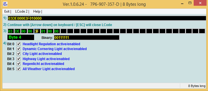

Has anyone managed to successfully disable the city of weather modes?
There are 3 modes in the long coding if I remember, you can turn off all of them or only 1 of them.
Have a look when plugged in

Turn city mode off with VCDS, lights won't wonder - problem solved.

It shouldn't be off to the off side at 60mph though, so it is sticking in City Mode.
As a workaround, City Mode can be disabled with VCDS, but that isn't the long term fix that Skoda need to come up with.

Looks like this is the coding in VCDS:
I think xpower mentioned having to reset the lights afterwards using basic setting -> 'basic headlamp setting' ?
