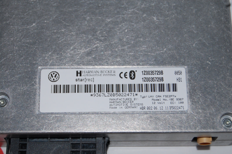

Have a look under the drivers seat for a black box. That's the BT module.
No box? Look for connectors (plugs) to see if the wiring is there.
If you have wiring, you could get a BT module for £60 or so.
If you're not sure if what you see, take pictures and post here.

I've checked and there is a silver box bolted to the floor under the drivers seat towards the front with a black plastic cover  and connector going into it.

That silver box is the BT module. So that's a good start.
Could you see a long part number on it in bigger letters / numbers (something like: 1Z0 035 729 B )?
This will help us help you with any potential issues or problems.
I suggest that you contact a local Briskodian near you (your location as 'England' doesn't help us offer you any assistance but this owners map might help you contact someone near you) as your module may be broken hence why it is not working.

I just get confused by all the different part numbers available, there's a bewildering amount to choose from  :wall:
No idea if this will work? Or do I need units beginning with 3C8035.......
