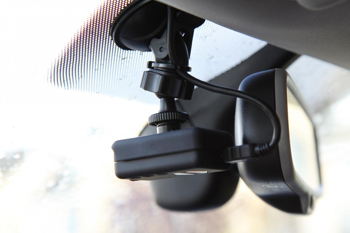

A Mobius with the wide angle lens, super capacitor and a 64GB card installed. Not sure on total cost as there were extra bits bought to wire this in but must be about £110 when you add the wire, blade fuse, 12v adaptor in.
I've been mocked by my colleagues for installing a 'spy cam' but funny how their tone changes when they see the footage and the quality! :happy:
Apologies for glare. You can just about make it out but looks like part of the mirror and sensors really if not looking for it. The Mrs doesn't notice it at all.
From drivers seat; barely visible.
Better view from below;
The 12v adaptor in my hidey hole. I use this for charging phones too.
I do like the look of the mobius ones as they look nice and small and discrete but all that is ruined by the massive mounts for them
True they're not exactly small but mine has gripped nicely to the black bit which I've seen people say to avoid. Plus you need it low enough for the cam to see past it too. There is an alternative mount that is more pearmanent as it has some double-sided tape on but I wanted to have the option to remove mine easily without mess if required.
Even with the bulk of the mount its tough to spot it.
