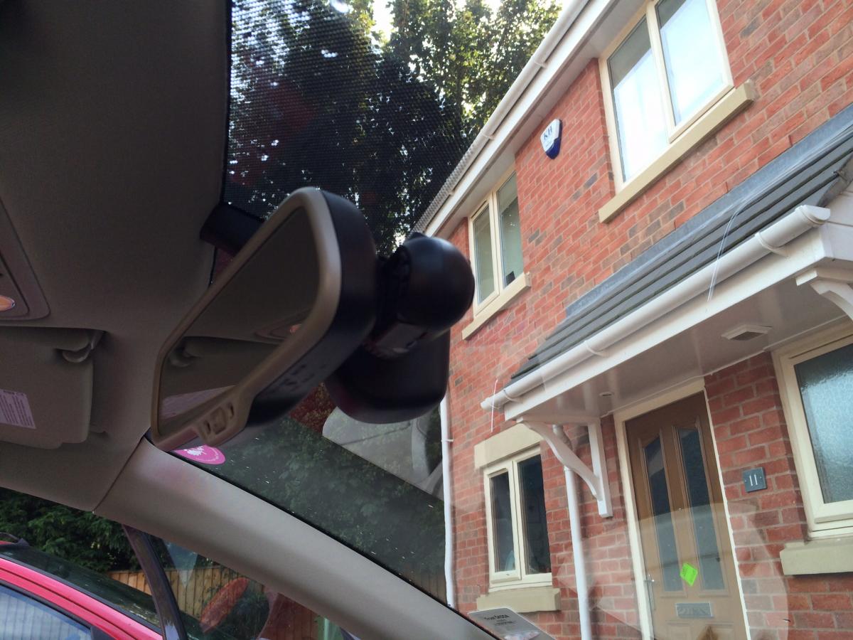

Here's my 803 in place. It's barely visible from the drivers seat, and while it's not facing exactly forward it's a very wide angle lens so shouldn't compromise the footage.

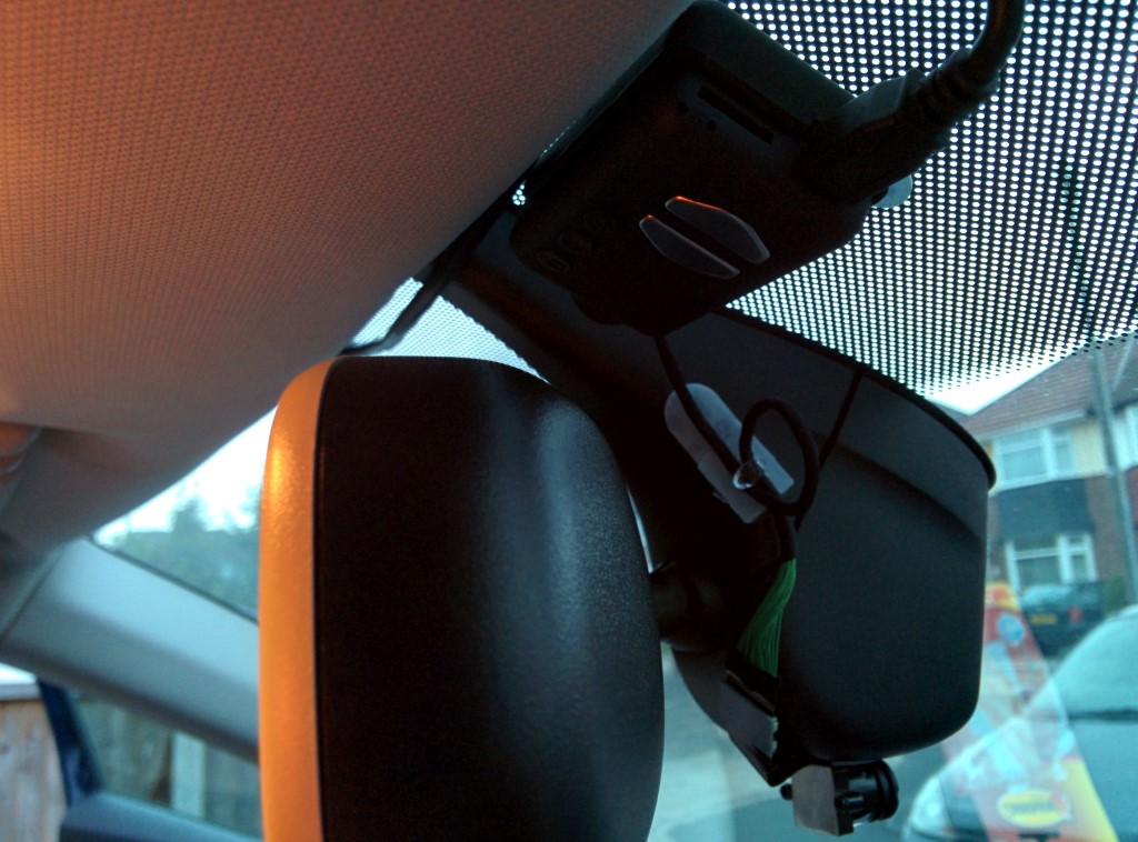

Looking back at your photos you have put it right against the lane assist camera unit etc. Mine has bobbles over the windscreen glass here but I can't see that on yours....is it just the photo or is your glass clear? I was hoping to stick mine in exactly the same place as the bobbles should obscure a bit of the camera from the outside but the lens sticks out just enough to avoid them and would have a clear view. Just worried about whether it would stick to the windscreen or not.
Apologies for the poor descriptions above!
I know what you mean, the the black dots are actually in between the two laminates of glass so that area if you feel it, is totally smooth.  Just be careful on how high you put it as you don't want it looking through an area of glass that isn't wiped by the windscreen wipers.

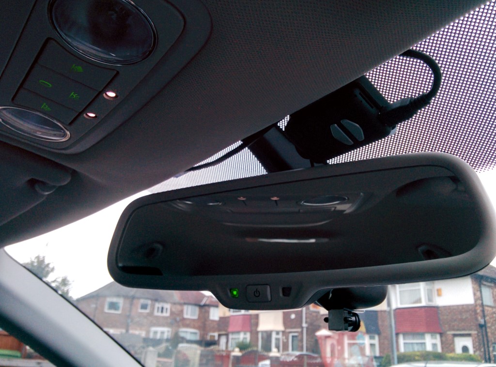

I've finished setting up my Mobius camera today... I finally had the guts to take off the plastic cover to hide the wire to the left windscreen column (note: my column didn't have an airbag symbol on the plastic, but did have an airbag inside [i think that was mentioned earlier in the thread]... I just tucked the USB cable above the airbag "thingy", alongside the other wires).
The Mobius camera lens is on an extension cable, so the only visible bit is the lens itself.
Everything's stuck on with 3M Mini Command Clips -- I got the "water resistant" ones (think this might help keep 'em stuck if there's any condensation of the windscreen in the morning, etc)
I tried it stuck on top of the mirror, but it got in the way adjusting the mirror.  Where it is now gives easy access to the MicroSD card & I can see both LEDs clearly.
I've also ordered a supercapcitor to replace the battery... but going to check everything's running OK before I change anything else.
