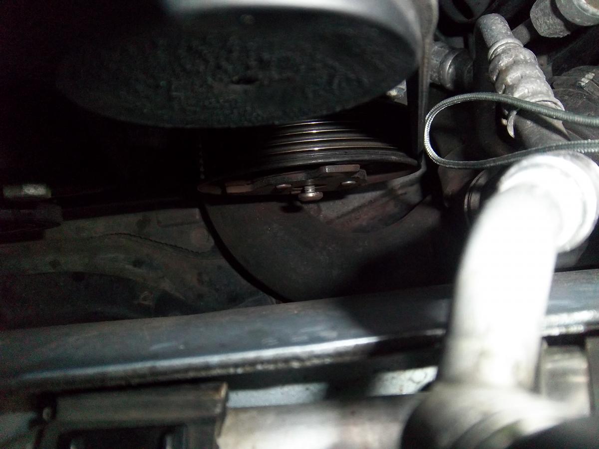

Have recently purchased my first Skoda Yeti, a 2010 Elegance 2.0D 140bhp 4x4, second hand from Snows Group. After a couple of weeks I realised there was an AC fault.
The AC fault was difficult to diagnose because it appeared be operating within its range via the Digital Display 18-26 degree Auto Setting, on startup, but several minutes later - on turning off AC, there was no decernible difference between having AC on, and AC off, of the circulating air due to low ambient temperatures in April. It appears Snows Group sold the car with the fault on the car at purchase.
With further investigation, getting it booked in for a diagnostic check/possible regas, with Skoda - the compressor, has been diagnosed as faulty, with a protruding torx T30 screw from the Denso Compressor. I've uploaded two pictures so that others can check for this common fault.
The Pulley rotates but the torx T30 screw (central thread) doesn't.

Do I presume that the screw should be totally screwed in, and therefore not visible?
Yep, thanks. Its more the time it takes to work out what is actually wrong (and thinking - if indeed anything was wrong - it was). The reason for the posting images to show others.
This is my understanding of it..
The T30 torx bolt holds the pulley in place on the tapered shaft of the compressor, but the T30 torx bolt is not spinning with the Pulley wheel (remains motionless when the Pulley is in motion). You'd think it was a case of tightening it up, but its possible its caused damage to the tapered shaft is my understanding, due to the pulley slipping. It would be helpful is someone can upload a picture showing a correctly working compressor (screw intact). The system is also correctly pressured (no leak), with the engine off,  which also makes you think the internals of the compressor are intact, just not rotating. Difficult to know until its removed/replaced.

I had a look this morning and snapped a pic.
Hex bolt now, it would seem.

Thanks Steve, shame its not exactly the same compressor. Also took the car to an Air Con Specialist (only does AC) in Redditch, who described the fault straight away on seeing a printout of the image. Very helpful guy, has been fault finding AC for 15 years. On asking whether other parts would need to be replaced, said 80% of the time, its a straight compressor swap, but a can of worms if there is debris in the circuit. But very common fault.

I had this problem on my 2012 MY Yeti TDI 170.  I bought one of these for £30.  It sorted the problem and only took an hour or so to fit.  No need to drain the A/C system.
https://x8r.co.uk/air-conditioning-a-c-delphi-compressor-5n0820803-audi-vw-seat-skoda-repair-kit.html
Their theory is that the centre Torx 30 screw comes loose and the splines on the shear plate eventually wear smooth as it wiggles about  and so there may well not be anything wrong with the compressor itself.
Hope this is of some use to someone.  It seems to work at the moment suggesting that the compressor is OK.

Driving along last weekend and heard a strange noise and around a mile later a rather unpleasant rattle coming from the engine of my 2.0 TDI 170 4x4 Yeti.  A quick investigation revealed that the source of the noise was the aircon compressor.  With the a/c switched on the pulley was stationary with the belt slipping.  Turning off the a/c the pully free wheeled - but still noisy.
Having read this thread I checked the torx bolt, but its tight and not protruding.  I'm guessing that this means its the compressor that needs replacing, not just the £30 repair kit?  Can anyone help confirm this?
Many thanks. J
That could only happen if the compressor itself has seized?
I have had the problem recently on my 2010 140 4x4 Yeti.  In the first place I got a Skoda dealer to do an aircon service and hence diagnose the problem of no cold air.  Their offered solution was compressor replacement with a quoted price of £705.  I decided to research further, and came away not realising that another fault had been introduced by the Climatronic ECU coding having been wiped during the fault finding, although I also knew the correct VAG compressor part number for my car (5K0 820 803).  After getting independent quotes, it transpires that replacing the compressor could cost anywhere from £300 to £600, with the average labour cost in that being around £100.  A used compressor from a crash damaged VAG car seemed to be about £80 if you know the correct part number to look for.   My solution ended up with this thread and a local AC experienced garage (Prolek West Wales) aiming me in the correct direction of checking that compressor screw, and getting it screwed back in properly.  Cost at the end of that £82 for the labour and a properly re-gassed system, but further trips necessary to the Skoda dealer to get the ECU coding re-programmed before the AC would operate again.  Net result is a working AC again and a saving of over £600 on the original quote.

The air con on my 2010 Yeti failed and I can see the bolt protruding from the centre of the shear plate. I was going to find if I can purchase the shear plate replacement but was advised that Skoda fitted several different compressors and there is no record of what was fitted to my car. How can I find out which compressor was fitted?
