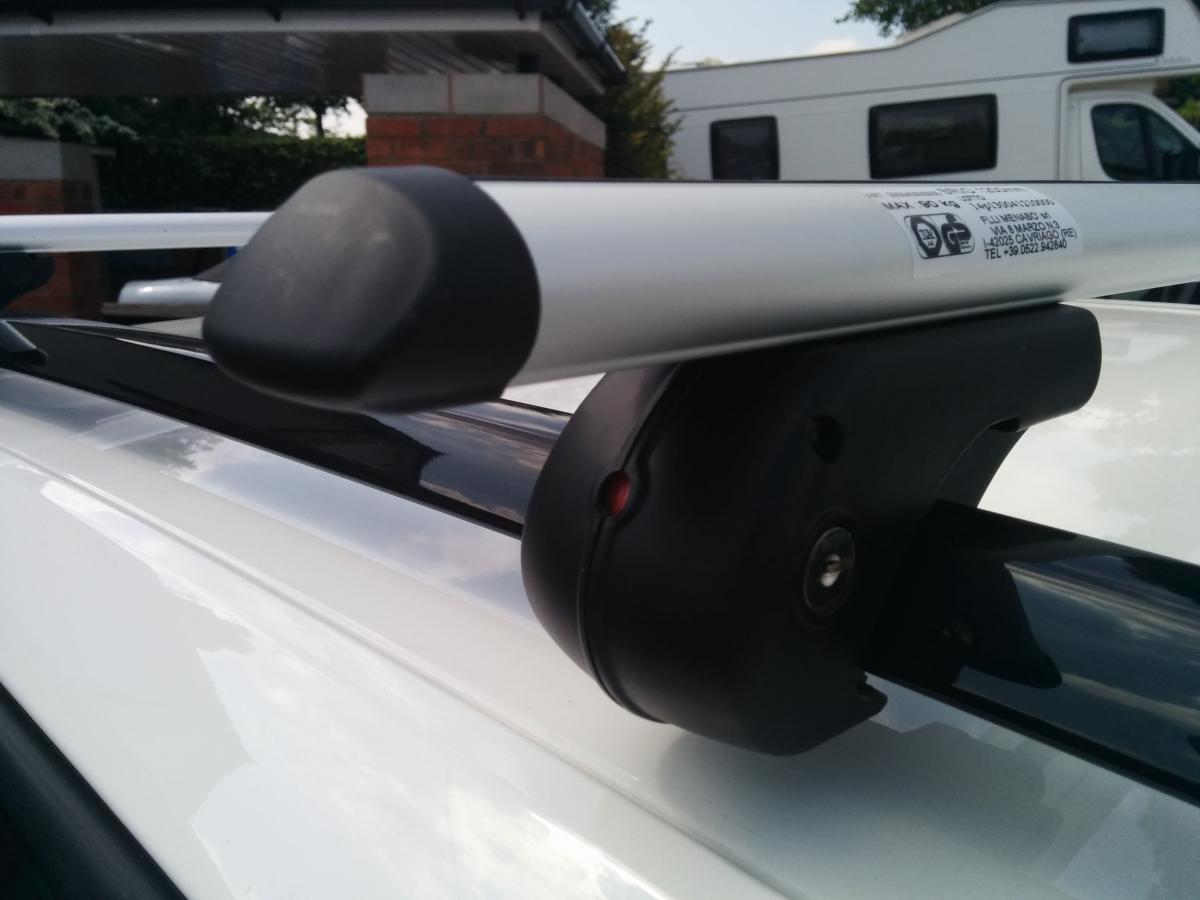

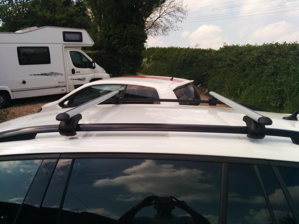

  • Here you go I've just fitted them and they appear to fit fine. (You'll have to excuse how dirty my car is!)
  • ...or these are good roof bars at a bargain price.
  • Another plus I've found with these bars is that if you have the variable boot floor they fit into the slots under the floor which are designed for the Skoda bars, which means they can be stored in the
Another plus I've found with these bars is that if you have the variable boot floor they fit into the slots under the floor which are designed for the Skoda bars, which means they can be stored in the car at all times.

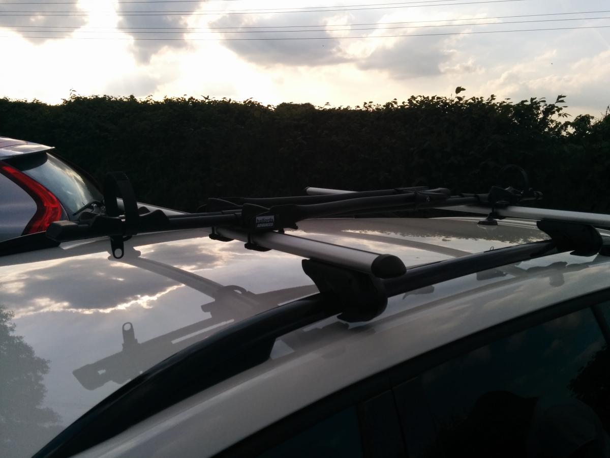

Here you go.... Finally got the kit fitted.
Got to say I was impressed for the money.... Locking system wasn't thule-grade, but can't complain and does the job.

Just to share my experiences.
Pros:
Fitting is very straightforward, taking less than 5 mins.
Solid fit and solid build for the price. I reckon the mechanism will last well if treated well. Time will tell.
The section that clamps to the rails is a pliable plastic which doesn't seem to scratch or mark.

The u bolts supplied with my bike carrier were annoyingly 1mm too narrow to fit around the aero bars (which are 46-47mm I think), which is why I had to use the T-track.  Also, the u-bolts I had were designed for square bars and the instructions stated they weren't suitable.  I imagine that this is because all the tension of the horizontal section of the u bolt would go through the centre of the lower curve of the bar.
If you have curved u bolts that fit then I can't see a problem.  If not, then probably cheaper to use the roofing bolts and washers above (£6) in the T-track, than hunt around for some different u bolts.  The M6 roofing bolts are normally tested to 50kg-75kg tensile strength each, so with four in use, they should withstand any forces they might encounter.
