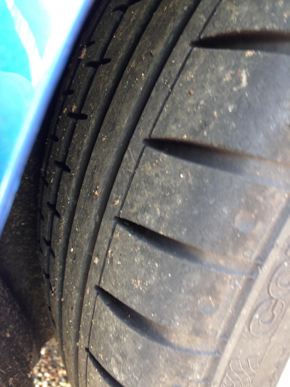

hmmm.. here's some photos...
Thats my rear tyre... which is fine.. i cant upload a picture of my front tyre becuase its above the maximum mb upload size on this website :(

photobucket pictures here.... the rear ones are okay though, does that not suggest the tracking is ok?
http://s1362.photobucket.com/user/jackmiers/library/
No necessarily.  The fronts have a lot more work to do than the rears due to steering, braking and power deliver.
There are various angles at work at the front, most of which which apply to the rears too - Toe-in/out, kingpin inclination, camber, ackermann (not rear unless you have a car with 4WS) etc - even tyre pressures can make a big difference.
As the power goes through the fronts and they are doing all the steering and 75% of the braking, any unusual wear will be exaggerated.
As others have said, get a full 4 wheel alignment done to be safe.  You might find you get noticeably better MPG as a byproduct of a well aligned suspension system.
