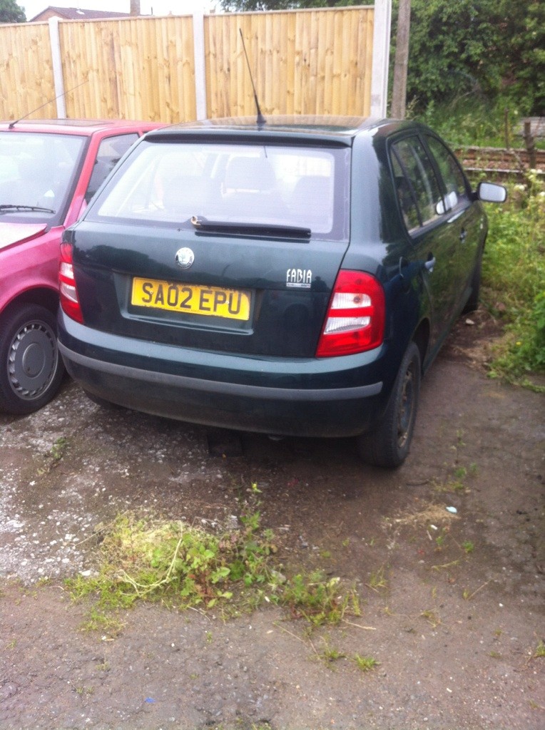

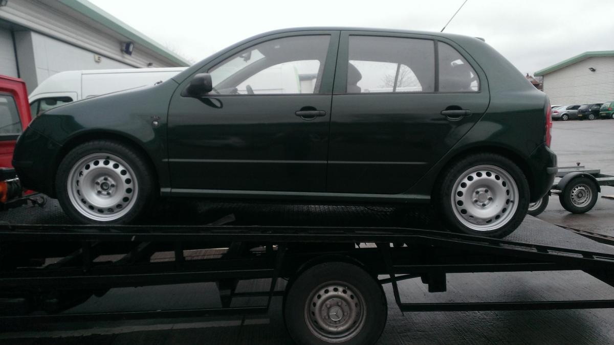

the car stared life off as a 1.4 8v with a 156k no mot no tax a blown head and bald tyres which cost me a grand total of a £140 through a friend in the trade, back in july last year. All that mattered was that the shell was in good order as the rest would been thrown in the bin. Since then the car has been on my driveway and been worked on by myself with a little help from some friends in the evenings after work and at the weekends, transforming it into the 275.4 bhp 300 ib/ft and 20 psi of boost sleeper it is today. will post more pictures and details of the work later

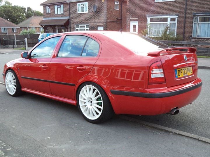

Off topic but what wheels were on the octavia?

team dynamics monza' 18" 7j sat nicely
