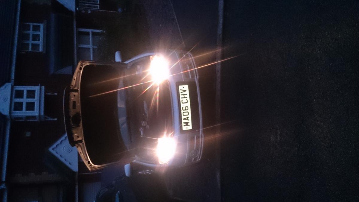

Fitted replacement headlights, only went for the halfords 50% brighter range as i get a massive discount.
Improvement isnt magical but its certainly noticeable!
